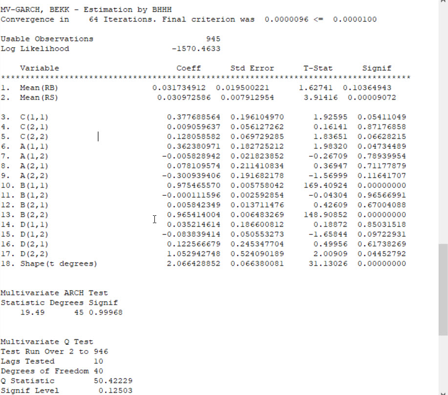

You have *really* serious issues. The t parameter can't be below 2 (actually can't even be 2), so that is right at the edge of the defined parameter range. It seems like your data are dominated by massive outliers that a GARCH model can't even come close to explaining.
Re: Structure Break in Variance Equation of MGARCH
Posted: Sun Dec 13, 2020 11:37 am
by prashantj
thanks. When I change the method=BHHH, I have got the estimate. Here is the output. But as you said GARCH model can't explain the massive outlier, which tool should I use to analyze such dataset if GARCH can't handle it? I am sorry to ask but this always is a big challenge when I every tried to estimate MGARCH volatility. It takes so much of efforts.

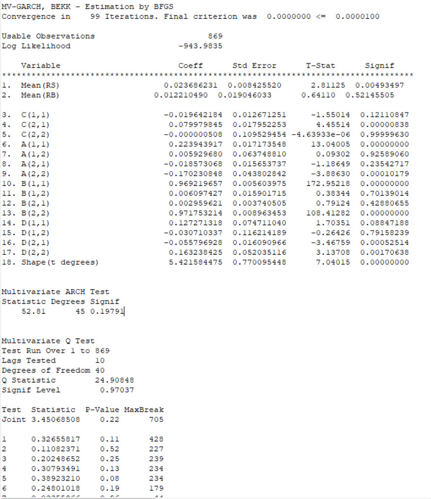

by prashantj
Thanks for your suggestion. I detected and adjusted for zero return and this is the output I got. It looks reasonable? please
Posted: Tue Dec 15, 2020 11:57 am
That looks like a well-behaved GARCH model.
