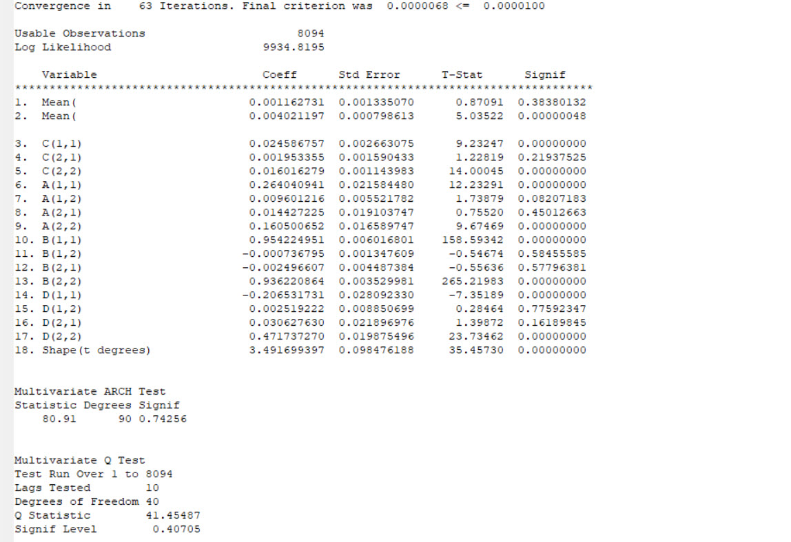

Finally, I think I have got the following model with my intraday data after adjusting for outliers, took a long! . I hope that is a good model, Tom?
Re: negative coefficients of ARCH terms in MGARCH-BEKK
Posted: Sat Nov 28, 2020 10:48 am
That looks more reasonable.

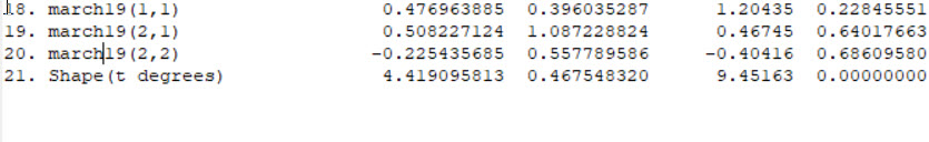

I was estimating BEKK MGARCH model by creating variance dummy using the procedure discussed in GARCH course workbook in Section 6.3 and I got the following output (am attaching truncated). I would like to get value for march(1,2). Is it possible to generate?
garch(mv=BEKK,rvectors=rd,hmatrices=hh,pmethod=simplex,asymmetric,xreg,stdresids=rstd,piters=20,iters=500,dist=T) / rsp rbg
# march19
Posted: Tue Dec 01, 2020 10:41 am
It's a lower triangular matrix (has to be---a full 2x2 matrix wouldn't be identified) so the 1,2 element is zero.
