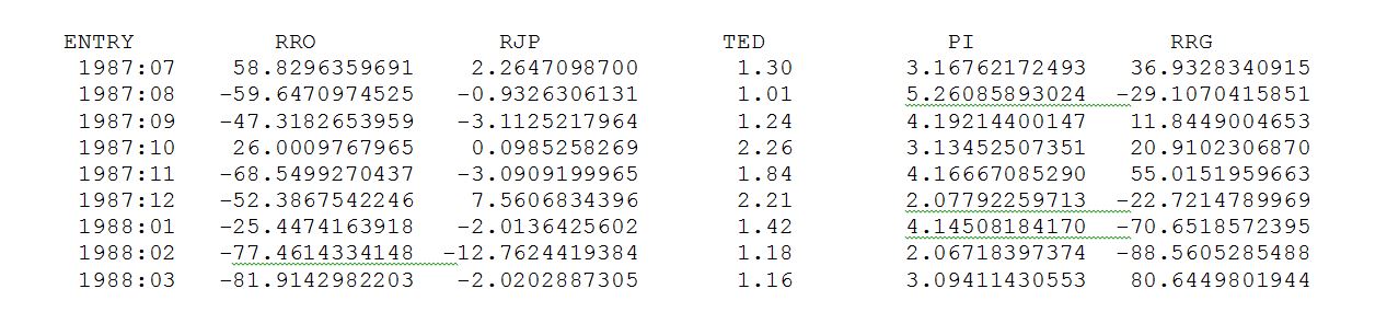

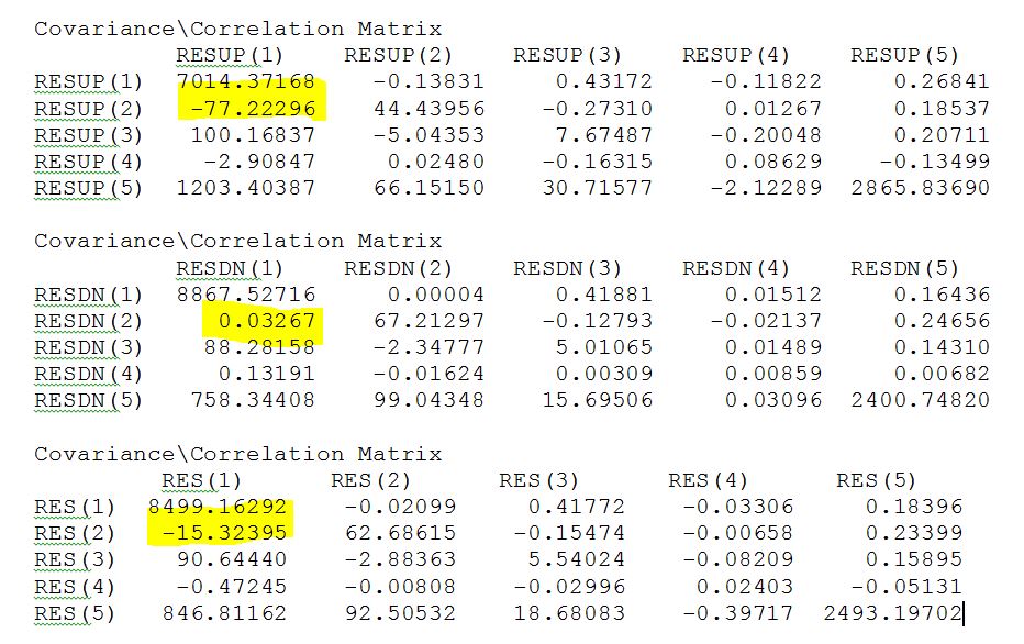

Hi, Tom,
I got another question about Covariance\Correlation Matrix. I'm not sure whether what I got looks right. I have five series in percent.
After estimation, their vcv in upper, lower and linear,regimes:
vcv
vcv
Does it seem right in terms of magnitudes?
Thank you,
J
Re: Balke(2000) Threshold VAR
Posted: Sat May 27, 2017 5:33 pm
Obviously a .00004 correlation is really small, but if you look at all three correlations for that pair, they're effectively zero so it may be a bit of a fluke, but isn't unreasonable.

Posted: Sat May 27, 2017 8:37 pm
by applej
TomDoan wrote:Obviously a .00004 correlation is really small, but if you look at all three correlations for that pair, they're effectively zero so it may be a bit of a fluke, but isn't unreasonable.
Thank you. Is the "7014" co-variance/variance ok? :roll:
Posted: Sun May 28, 2017 12:43 pm
Why wouldn't it be? This is your model and your data---it looks like a noisy series and the three values for that 1st variable variance are all relatively similar, so I'm not sure what you think is the problem.

Posted: Fri Jun 30, 2017 10:35 am
by applej
TomDoan wrote:Why wouldn't it be? This is your model and your data---it looks like a noisy series and the three values for that 1st variable variance are all relatively similar, so I'm not sure what you think is the problem.
Thanks. It's just too large. But I think the calculation is right.(It's real oil return. )
