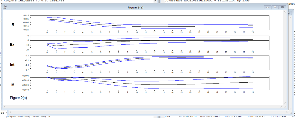

I'm new to RATS and now I'm trying to replicate the Cushman and Zha (1997) paper for a course project.
I had a relatively large dataset, but for simplicity, I chose the first five domestic variables and two exogenous variables from US. I read the original code of the paper and tried to find answers from the user's guide and online forum, but some problems are still not fixed on my end. I attached my code and dataset for reference.
My questions are:
1. The biggest one is that when I try to get the domestic money shock responses, it seems the shock is not from a change in interest rate, and I have no idea which variable brings the shock.
   compute [vector] money=%xcol(faclast,3)
   compute money=%if(money(2)>0.0,-1.0,1.0)*money
   impulse(noprint,model=surmodel,shock=money,$
      results=impulses,steps=steps)
To my knowledge, this part seems to deal with the shock, and since the interest rate is the third variable in the system, I get the third column out of the matrix. Please let me know which part of code was wrong.
2. Refer to the above code, I can't understand what
means, although it's explained that this line "makes sure the shock as the desired sign". I suppose this has something to do with my first question, but I have no idea how to fix it.

bjing wrote:Hi,
compute MSResponses=||"R","Ex", "M","Int","P",$
"RInt","REx"||
doesn't match with
system(model=openmodel)
variables lnR EXR Int lnM2 Inf
In one of the two, you have M and INT switched.
bjing wrote: 2. Refer to the above code, I can't understand what
Any column in the A matrix can be have its sign flipped without changing the model (since the diagonals aren't normalized to 1). As written in your code (which may not be correct; depending upon how you fix #1), this makes sure the contemporaneous response of variable 2 to shock 3 is negative.
bjing wrote: 3. The last part of my code which is intended to do the responses for shock from US reports an error. I tried a lot but failed to find the solution.
@MCProcessIRF(nvar=NUSResponses,center=median,$
   irf=irf,lower=lower,upper=upper)
do i=1,NUSResponses,4
   ewise thispage(j)=USResponses(i+j-1)
   spgraph(vfields=4,ylabels=thispage,samesize,$
       footer="Figure 3"+pageref(%block(i,4)))
   do j=i,%imin(i+3,NUSResponses)
      graph(nodates,number=0) 3
      # irf(j,1) / 1
      # lower(j,1) / 2
      # upper(j,1) / 2
   end do j
It looks like you have some typos in this:
compute %%responseus(draw)(1,h)=impulses(1,1)(h)
compute %%responsems(draw)(1,h)=impulses(1,1)(h)
compute %%responsems(draw)(2,h)=impulses(2,1)(h)
compute %%responsems(draw)(3,h)=impulses(4,1)(h)
compute %%responsems(draw)(4,h)=impulses(3,1)(h)
compute %%responsems(draw)(5,h)=impulses(5,1)(h)
compute %%responsems(draw)(6,h)=impulses(3,1)(h)-(impulses(5,1)(h+3)-impulses(5,1)(h))*400.0
compute %%responsems(draw)(7,h)=impulses(2,1)(h)+impulses(5,1)(h)-impulses(6,1)(h)
compute %%responseus(draw)(8,h)=impulses(6,1)(h)
compute %%responseus(draw)(9,h)=impulses(7,1)(h)
Those should all be %%responseus(draw)....
bjing wrote: 4. With respect to some previously asked questions, I have something more to say.
compute c=.9*inv(%decomp(y2m2))
Can I use .9 as my adjustment directly?
Yes. It's just designed to get if off the ML values which improves the behavior of the sampler

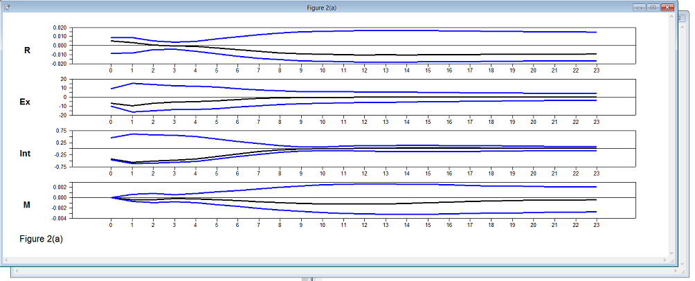

Thanks for the quick response. I changed my code according to your suggestions. Two questions came up as follows.
1. It seems the response of the interest rate to itself is still negative.
2. The results I get from the Covariance Model-Likelihood - Estimation by BFGS is local optimum, not global optimum since the values from "log likelihood" and "log likelihood unrestricted" are different. I tried tens of different initial values but failed to make these two the same. I noticed that the code you provided for Cushman and Zha (1997) paper also had the same problem, so I suspect this doesn't influence the final impulse responses. Should I continue to try if I want to have the global optimum? How would this influence the final outcome?
Thanks again for answering my questions.
Re: Cushman & Zha JME 1997
Posted: Wed Sep 06, 2023 11:34 pm
bjing wrote:Thanks for the quick response. I changed my code according to your suggestions. Two questions came up as follows.
bjing wrote: compute [vector] money=%xcol(faclast,3)
*compute money=%if(money(4)>0.0,-1.0,1.0)*money
The second line is commented out. The combination is also wrong for the order of your series. I assume you want the fourth shock to be money, so the 3 should be 4. And interest rate is series 3, not 4 in the second line.

Actually I tried to make interest rate the shock, and that's the third variable in my system. I made some changes to make it easier to read.
compute [vector] rate=%xcol(faclast,3)
In this case, if I want to make sure the fourth variable ("money") responds negatively to the interest rate shock, I need to make it this way:
compute rate=%if(rate(4)>0.0,-1.0,1.0)*rate
But this will give really weird responses of all the variables, i.e., all of them become insignificant, let alone the positive interest rate shock and the negative money response.
after apply the constrains from money.png (54.99 KiB) Viewed 42227 times
Then I tried to comment out the previous line, but this gave negative initial response of interest rate to itself, which doesn't make sense.
The negative interest rate response to itself.png (82.42 KiB) Viewed 42227 times
I also tried different variables under the same method. In some cases, I also have the same issue that the own initial response is negative.
I also attached the screenshots for these two cases.
