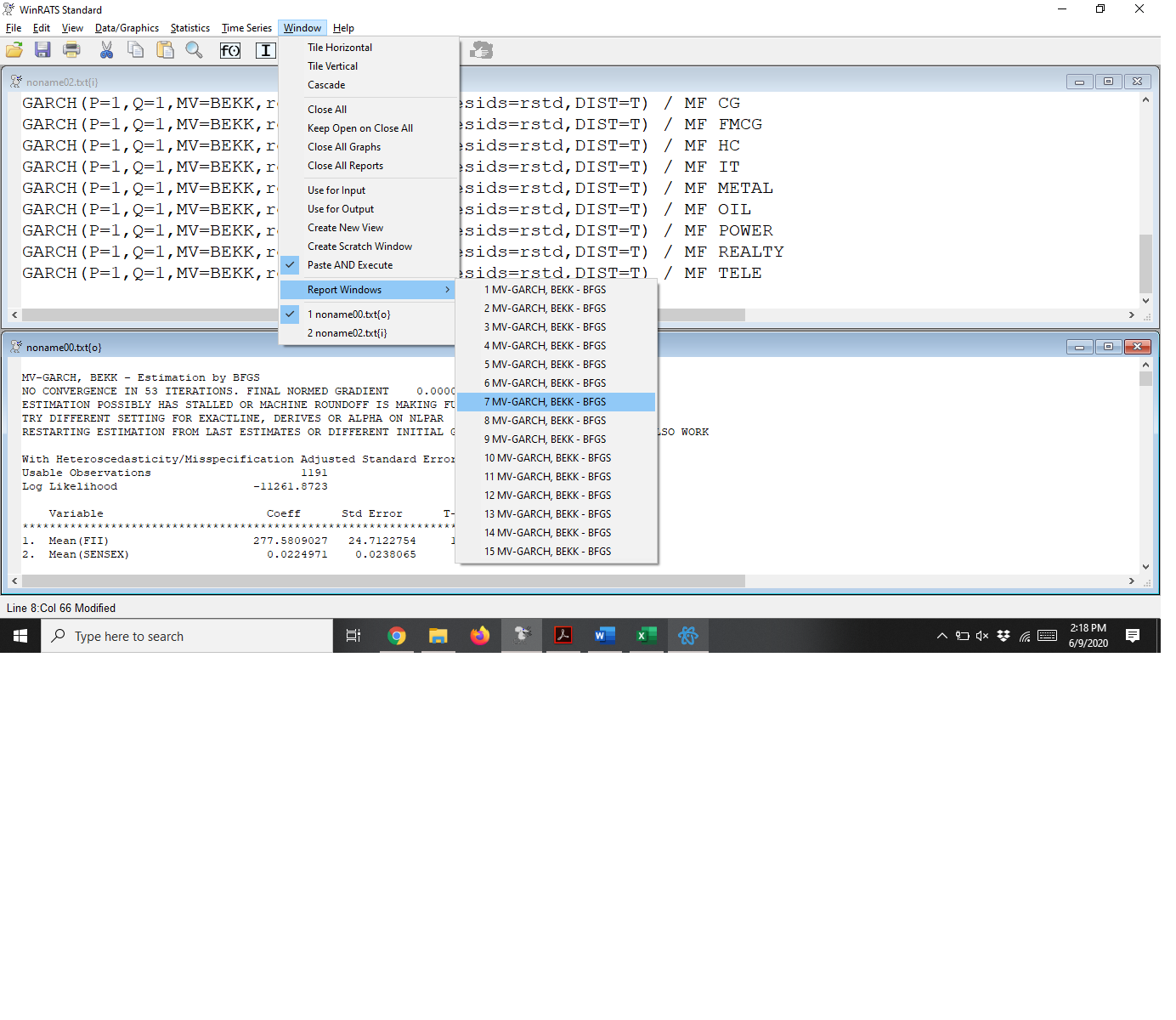

Posted: Tue Jun 09, 2020 3:47 am
by curiousresearcher
I used the report function and it does allow me to reduce decimals and then save the output by going to export function and saving as comma seperated file. The output is perfect as i want.
But i am only able to do this for 1 bekk garch command at a time. So if there are 15 different combinations, then i have to save 15 times different comma seperated files. Cant i save all the results in a comma seperated files?
This will be real life saver for me and other users like me.
