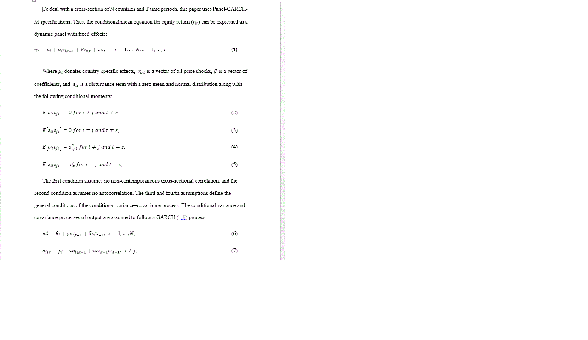

Could you be more specific about your model? (You can attach a formula in a GIF).
Re: Panel GARCH? (Cermeno and Grier, 2006)
Posted: Mon Sep 22, 2014 3:04 pm
by Fathi71
PANELGARCH model.gif (46.39 KiB) Viewed 202067 times
Attached is my model and specifications, where N= 5 series.
if you have question let me know, with my appreciation
Posted: Tue Sep 23, 2014 10:32 am
I may be misunderstanding what you were asking. What you posted uses a standard Panel GARCH model for the variance, but uses a more complicated mean model with lagged variables and M effects. Is that what you want, or are you looking for a different type of variance model?
Posted: Tue Sep 23, 2014 6:31 pm
by Fathi71
As mentioned above, I am looking for unrestricted coefficient of variance equations. can you find way to make variance equations coefficients vary?
Don't worry about mean equation!
