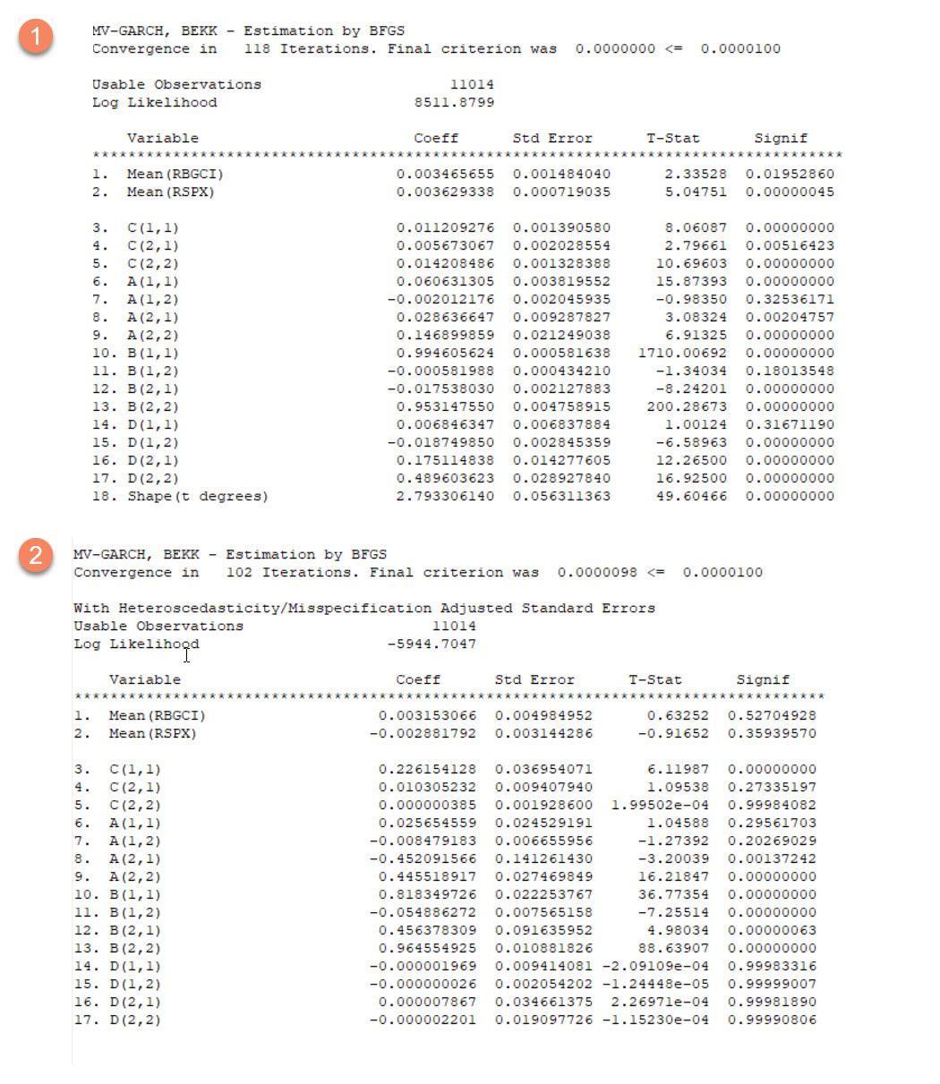

When I choose t-errors and estimate BEKK MGARCH, the D coefficients are turning out to be statistically significant as follows:
GARCH(P=1,Q=1,MV=BEKK,DIST=T,ASYMMETRIC) / RBGCI RSPX
And when I use the following command, The D coefficients are insignificant. I do not know why it is and which one is correct.
garch(mv=BEKK,rvectors=rd,hmatrices=hh,pmethod=simplex,asymmetric,robusterrors,stdresids=rstd,piters=20,iters=500) / rbgci rspx
Re: negative coefficients of ARCH terms in MGARCH-BEKK
I'm going to guess that you have some really serious issues with your data. You don't get a t of 2.79 (it has to be bigger than 2) without some really huge outliers that can't be explained by the GARCH recursion.

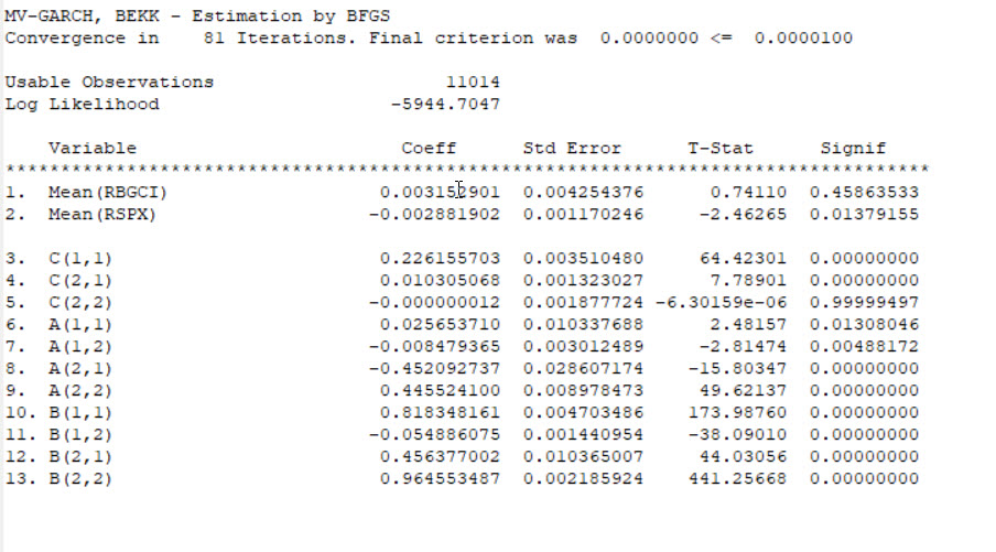

This is what I got when I use the following after adjusting for outliers.
garch(mv=BEKK,rvectors=rd,hmatrices=hh,pmethod=simplex,stdresids=rstd,piters=20,iters=500) / rbgci rspx
MGARCH diagonstic test suggests model is good fit. I think it is a good model?
No it doesn't. It's a terrible fit---look at the log likelihood difference between the model with t errors and this one. Tests for serial correlation (either in the mean or in second moments) will basically always "pass" if applied to a series with isolated outliers (the standing assumptions underlying those tests don't allow for outliers, so the tests don't behave properly in the presence of them).

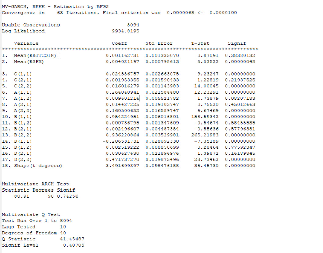

Thanks. How to deal with outliers in MGARCH? is better to use t-error model or GED better? or just remove the outliers. Mine is intraday data. How to deal with the outlier? please guide. Does help manual or GARCH course include it?
Prashant
Before you decide that, you have to figure out what the source of the problems are. If it's intraday data and it doesn't trade 24 hours a day, one assumes that there can be big differences between the end of one day and the start of the next; in which case, you need to use a more complex model, since a GARCH model which treats every observation identically isn't correct for that. Sometimes there are typos; sometimes there are phantom prices that don't represent any actual trades (for instance, if a circuit breaker prevents a price from moving too fast, typically no transactions will be made at the capped price). This is your data set and it's your job to figure out how it works.
