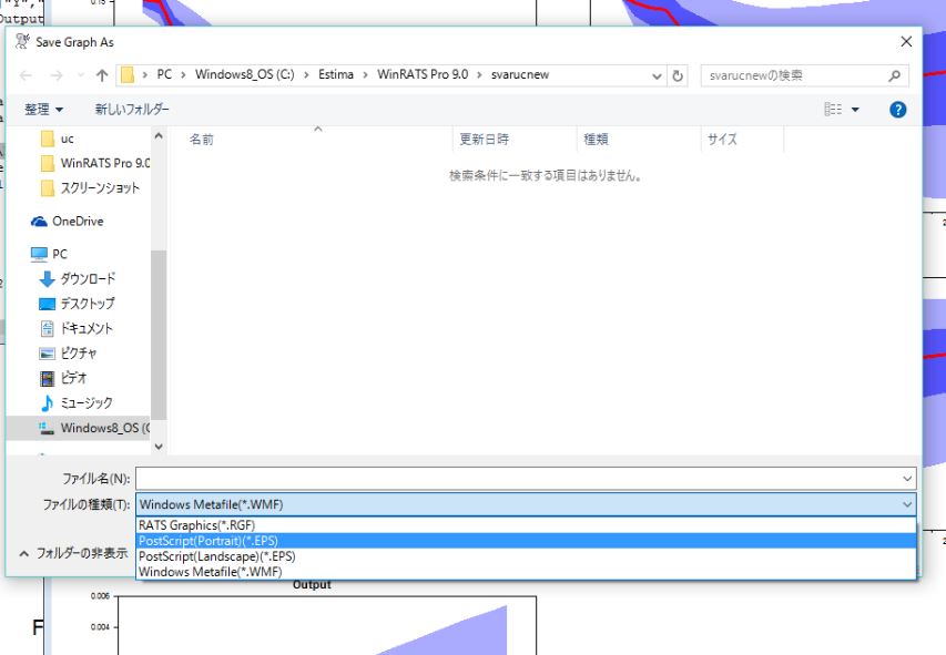

It means i click the graph and save it as an eps graph as shown in graph attached ,but it failed to appear in latex.
And I also change the root into
environment gsave="c:\Estima\output.eps" gformat=portrait
,the graph was saved but it also cannot be read in latex this time.

I am sorry ,it means when I add the eps graphs produced by Rats in a latex file ,the error as attached appears .... i have tried many other ways to import the graphs produced by rats into latex,such as converting the wmf format into png,it works fine but the graph is not that clear.
