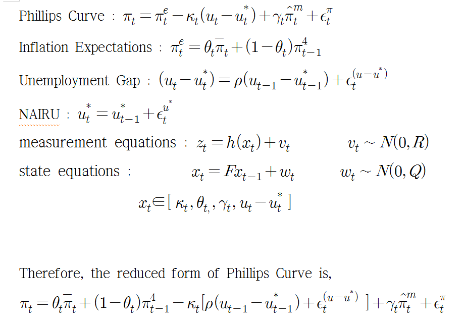

I am still working on it. Let me ask you sever questions about the model (the attached file).
1. I rewrite the equations in the type of reduced form in the attached file. In the reduced form, theta, anchoring coefficient, shows eventually the relationship between 'real inflation (headline CPI inflation)' and 'long-run inflation expectations' . So, can I say that the anchoring coefficient of this paper means how significantly 'long-run inflation expectations' affects 'real inflation', not 'weighted average inflation expectations'? This could sounds very natural or silly but the authors did not define 'anchoring', so I ask you.
2. Can I think that your code is for one reduced form equation with time varying coefficients?
3. State equations includes 4 varibles - kappa, theta, gamma, and u-u*. Unlike others which are estimated in the equations, u-u* is given exogenously - u* is hp filtered u. Is this OK, I mean, don't we have to estimate u* 'in the model'?
- equations for questions.png (28.4 KiB) Viewed 63663 times
