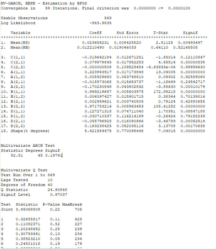

You have *really* serious issues. The t parameter can't be below 2 (actually can't even be 2), so that is right at the edge of the defined parameter range. It seems like your data are dominated by massive outliers that a GARCH model can't even come close to explaining.

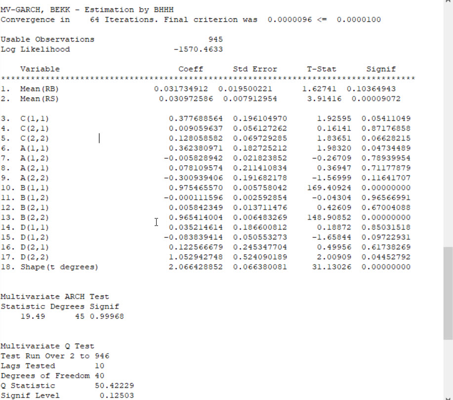

thanks. When I change the method=BHHH, I have got the estimate. Here is the output. But as you said GARCH model can't explain the massive outlier, which tool should I use to analyze such dataset if GARCH can't handle it? I am sorry to ask but this always is a big challenge when I every tried to estimate MGARCH volatility. It takes so much of efforts.
Re: Structure Break in Variance Equation of MGARCH
The first is to make sure that the outliers are actually "outliers" and not some form of typo or non-trading "price".
The jump-GARCH model is an alternative which allows for discrete jumps which don't really interact with an underlying GARCH process.
