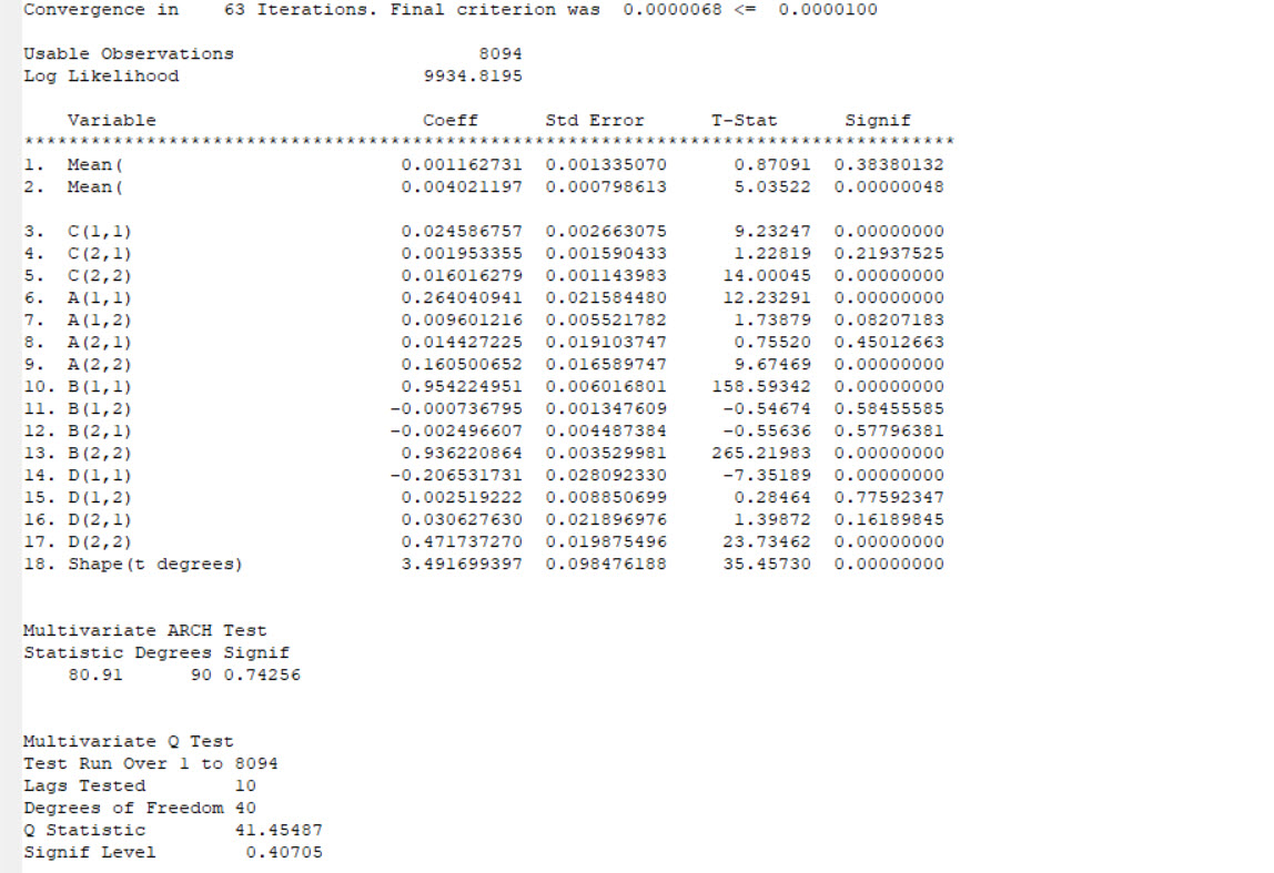

negative coefficients of ARCH terms in MGARCH-BEKK
Re: negative coefficients of ARCH terms in MGARCH-BEKK
There's no way I could tell from that. Have you even graphed your data? You should know whether there are issues even before you fit a model.

prashantj
Posts: 88
Joined: Sun Apr 11, 2010 2:56 am
Unread post by prashantj »
Finally, I think I have got the following model with my intraday data after adjusting for outliers, took a long! . I hope that is a good model, Tom?
That looks more reasonable.

prashantj wrote:This is what I got there are some outliers, but these are what I think we find with GARCH series?
Graph.RGF
The series is black seems to have a quite a few big outliers of opposite signs in close proximity (possibly adjacent entries) with no apparent effect on volatility subsequent to that. That tends to be a sign of either a one data point typo in the price series or some other move and immediate correction that is seen in the market as an obvious fix.

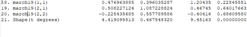

I was estimating BEKK MGARCH model by creating variance dummy using the procedure discussed in GARCH course workbook in Section 6.3 and I got the following output (am attaching truncated). I would like to get value for march(1,2). Is it possible to generate?
garch(mv=BEKK,rvectors=rd,hmatrices=hh,pmethod=simplex,asymmetric,xreg,stdresids=rstd,piters=20,iters=500,dist=T) / rsp rbg
# march19
It's a lower triangular matrix (has to be---a full 2x2 matrix wouldn't be identified) so the 1,2 element is zero.
