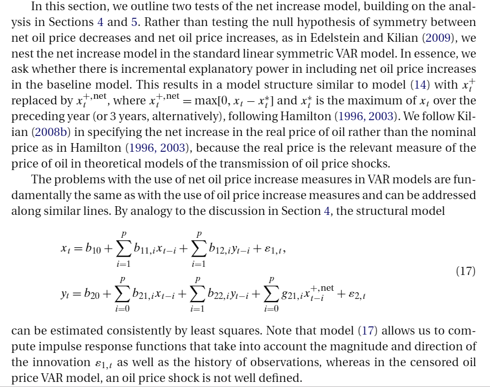

Dear Tomdoan......this is from The original "Are the responses of the U.S. economy asymmetric in energy price increases and decreases?" paper.....in their net model they have replaced xplus with xnet which is net increase in oil price from previous 1 year or 3 years high..... I am trying to modify the code based on net increase model.....
- Oil price NET model.PNG (157.32 KiB) Viewed 30237 times
Re: Kilian and Vigfusson (2011)
You can use MVSTATS to compute the maximum value of a series over a certain number of periods. In this MAX4 is the maximum over T-3 to T and MAX12 is the maximum over T-11 to T.
