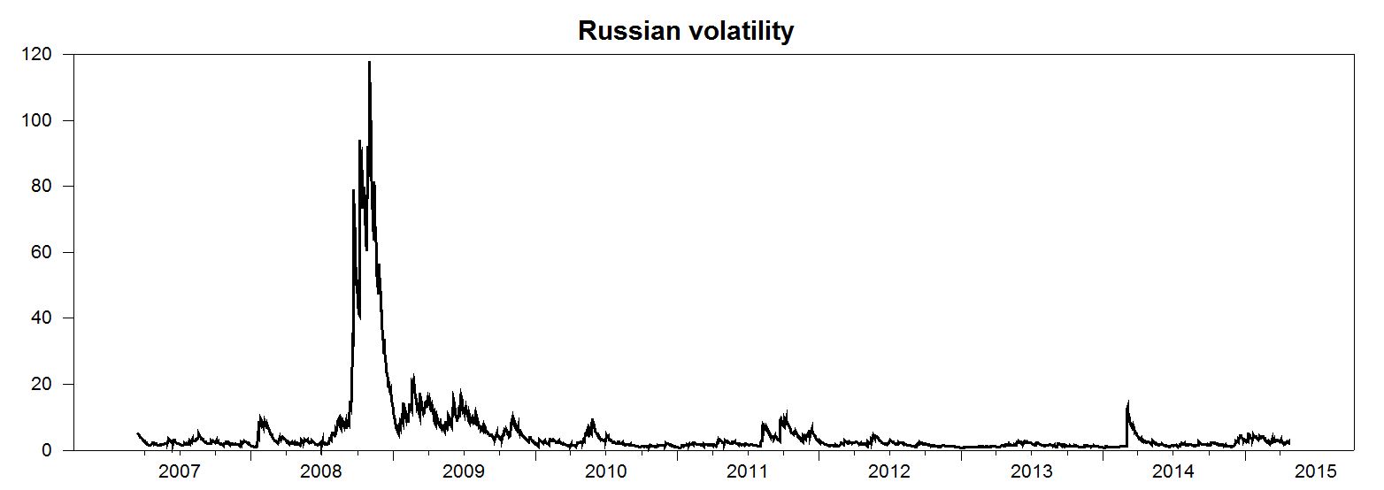

I would be really grateful if someone could help me on this matter.
Since I managed to get dcc-graphs, I´m deeply in need of garch volatility (variance) graphs.
I tried to use following code for it:
garch(p=1,q=1,resids=u,hseries=h) / lrussia
GRAPH(STYLE=LINE) 1
# H
But the results seems to be quite weird. How to measure it correctly ?

- Russia.JPG (60.37 KiB) Viewed 396758 times
Re: Beginner problems in DCC-GARCH
Why do you find that weird? That looks like a GARCH variance estimate for a series with one major volatility episode. You might want to graph this in standard deviation form, which will at least compress the scale a bit.

Thank you Tom!
It was the huge scale and lack of effects of 2014 crises that made me hesitate.
How do I graph it in standard dev. form?
set stddev = sqrt(h)
GRAPH(STYLE=LINE) 1
# stddev
GRAPH(STYLE=LINE) 1
# stddev
