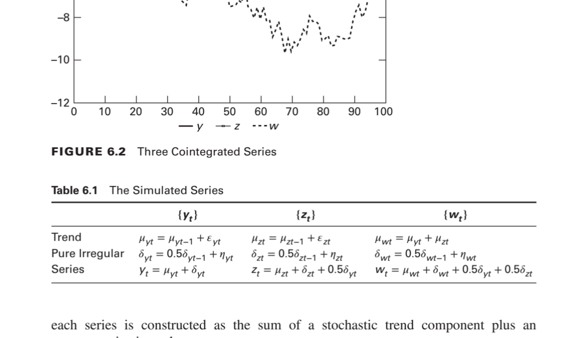

The motivation in simulating cointegrated series is from Enders(1996) HETS CH6 Figure 6.2: Three Cointegrated Series.
- I'd like to know how the plot was generated.
- Thus how to recover the coefficients from the simulation in estimating a VECM (and further seeing how deterministic terms affect results) -- as I would in simulating an AR, MA or VAR process in RATS.
My 3 variable VECM simulation example in the other thread, I do not fully understand as I guessed at the coefficients, and also the variable construction, to create significant ECT variables. From undergrad Maths in a standard e-value/e-vector problem I know that e-values are unique and e-vectors are non-unique, and for a generalized eigen-space as-well. As the e-vectors are non-unique, and as you have stated in the other thread viewtopic.php?t=3695&start=15

ac_1 wrote: ↑Tue Nov 12, 2024 2:52 am The motivation in simulating cointegrated series is from Enders(1996) HETS CH6 Figure 6.2: Three Cointegrated Series.
Doesn't he give the formulas used?
Note that there are several ways to generate series which are cointegrated. Figure 6.2 first generates the stochastic trends, then adds stationary behavior around those. That will not directly give you the VECM representation---in fact, the VECM can be quite a complicated function of the parameters in a model built that way. The 3 variable example earlier does a direct simulation of the VECM.
No. p.162 in the Handbook says the 100 observations of 3 simulated variables are on the file COINT1.PRN.
Please can you give example(s) in RATS so the affect of the 5 DET terms can be seen?

This is from the 4th edition of the book.

TomDoan wrote: ↑Wed Nov 13, 2024 7:40 am This is from the 4th edition of the book.
Thanks. Correct?
allocate 150
set eps1 = %ran(1)
set eps2 = %ran(1)
clear(zeros) yt yd y
set(first=0.0) yt = yt{1} + eps1
set(first=0.0) yd = 0.5*yd{1} + eps2
set(first=0.0) y = yt + yd
set eps3 = %ran(1)
set eps4 = %ran(1)
clear(zeros) zt zd z
set(first=0.0) zt = zt{1} + eps3
set(first=0.0) zd = 0.5*zd{1} + eps4
set(first=0.0) z = zt + zd + 0.5*yd
set eps5 = %ran(1)
clear(zeros) wt wd w
set(first=0.0) wt = yt + zt
set(first=0.0) wd = 0.5*wd{1} + eps5
set(first=0.0) w = wt + wd + 0.5*yd + 0.5*zd
prin / y z w
graph(key=upright) 3
# y 51 150
# z 51 150
# w 51 150
Re: Model of the US Economy: CointegratedVARModelHandbook
That looks correct.
