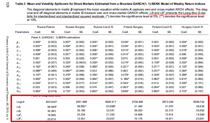

Here´s an example of desired output table (in red). Hopefully it will clear the previous question. So that can be done via mvarchtest and mvqstat? The last question, does RATS show in the output when output from Q-test is significant? Since that was one point in this.
- This is not similar to my study, but the Q-stats are done in a similar way I´m wanting to do

Re: Beginner problems in DCC-GARCH
The way I read that, those are the tests on univariate standardized residuals---they're not the multivariate diagnostics. See the top of Section 9.4.6 in the User's Guide. @BDINDTESTS does both the LB test, the McLeod-Li test (which is the LB^2) and a few others.
RATS doesn't automatically * the significant results---everyone has their own definitions for what levels need to be highlighted and how.
Regarding the results, it looks like there is a (modest) amount of serial correlation in the Russian series (which I'm assuming is #1 in the first three pairs) which isn't being modeled.
