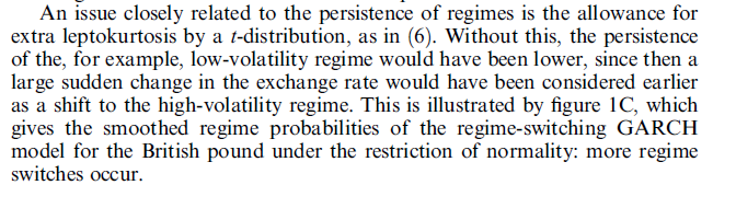

TomDoan wrote: Note, also, that the only thing that takes out of Dueker is the t-distributed errors. Other than that, they're using the Gray filter.
In this article the author says that:
https://link.springer.com/article/10.1007/s001810100100
Re: Gray JFE 1996 Markov Switching GARCH model
Posted: Fri Jun 30, 2017 3:49 pm
