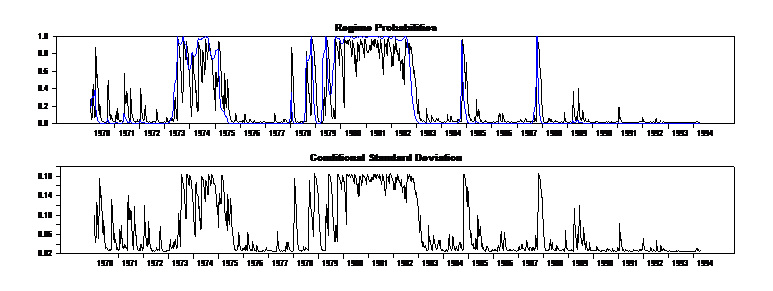

Thank you very much for your help. I fixed it. But why conditional variance just mimics regime probabilities? In the Gray's paper it is said that "no longer do conditional variance estimates mimic regime probabilities".What's wrong with it?

Re: Gray JFE 1996 Markov Switching GARCH model
It looks like you're graphing the original calculation. You need to do the calculations after the MAXIMIZE instructions for the MS-GARCH and you have to make sure you graph the square root of H, not the carryover standard deviation from the simpler model.
