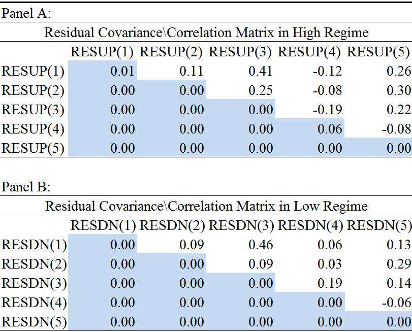

Hi, Tom,
I got the upper and lower regime covariance\correlation matrices. I want to put it in my paper to demonstrate regime difference. However, almost all covariance pair show zeors, which does not show regime-distinctive enough. Does that look acceptable? Or, how can I increase the decimals in the matrices ?
Thank you,
J
Thank you,
J
- tvar_vcv.JPG (120.35 KiB) Viewed 26675 times
- Posts: 7825
Re: Balke(2000) Threshold VAR
If you're using logged variables, the simplest solution is to switch to 100*log's which will shift the scale on the variances by 10^4. However, you can reformat the existing numbers by using Window-Report Windows to reload the report, and then View-Change Layout.

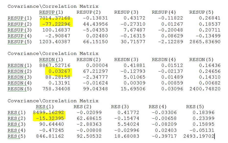

Hi, Tom,
I got another question about Covariance\Correlation Matrix. I'm not sure whether what I got looks right. I have five series in percent. After estimation, their vcv in upper, lower and linear,regimes:
Does it seem right in terms of magnitudes?
Thank you,
J
Thank you,
J
- Posts: 7825
Obviously a .00004 correlation is really small, but if you look at all three correlations for that pair, they're effectively zero so it may be a bit of a fluke, but isn't unreasonable.
applej
- Posts: 20
- Joined: Thu May 14, 2015 9:17 am
Thank you. Is the "7014" co-variance/variance ok?TomDoan wrote:Obviously a .00004 correlation is really small, but if you look at all three correlations for that pair, they're effectively zero so it may be a bit of a fluke, but isn't unreasonable.
- Posts: 7825
Why wouldn't it be? This is your model and your data---it looks like a noisy series and the three values for that 1st variable variance are all relatively similar, so I'm not sure what you think is the problem.
applej
- Posts: 20
Thanks. It's just too large. But I think the calculation is right.(It's real oil return. )TomDoan wrote:Why wouldn't it be? This is your model and your data---it looks like a noisy series and the three values for that 1st variable variance are all relatively similar, so I'm not sure what you think is the problem.
