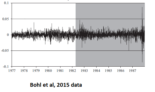

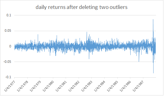

It seems that they have deleted two outliers from the data set: 10/19/1987 (SP500: 224.84) and 10/20/1987 (SP500: 236.83). It can be seen somehow by comparing their graph of daily returns of SP500 with the following graph that has been drawn by deleting those tow outlires:

Other than color, those graphs appear to be identical. However, the data set has no October 19, so although the drop from October 16 to October 20 is still rather large, taking out October 19 eliminates a truly massive outlier followed by a rebound outlier.
It remains the case that there is no evidence that there is any real change in the process after 21 April 1982 when futures contracts were added and analyzing that was supposed to have been the point of the paper. Even with seven extra parameters, they only got an improvement in the log likelihood of about 9 (which is pretty bad with 2800 observations) and if you look at their Figure 5, all that the "model" is doing is picking out a couple of isolated outliers having nothing to do with the date of the known regime change. You're now 70+ posts and six months into this. It's time to give it up---there's nothing here.
