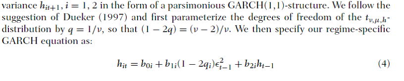

Their model is based on Gray" paper. But when they want to specify the GARCH part of the model, they say:
I don"t know how to include this in the Gray' code and write a new code for running the model.
Re: Gray JFE 1996 Markov Switching GARCH model
Posted: Wed Jan 18, 2017 2:19 pm
That's only a minor part of Dueker's paper---they're using the Gray approach, but using t errors (as Dueker did) rather than Normal (as Gray did).
My recommendation is that you just adopt Dueker's method entirely. Gray's is less accurate and more complicated.

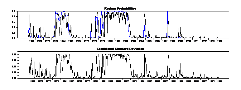

Thank you very much for your help. I fixed it. But why conditional variance just mimics regime probabilities? In the Gray's paper it is said that "no longer do conditional variance estimates mimic regime probabilities".What's wrong with it?
figure 5.png (20.5 KiB) Viewed 219380 times
Posted: Wed Jan 25, 2017 2:48 pm
It looks like you're graphing the original calculation. You need to do the calculations after the MAXIMIZE instructions for the MS-GARCH and you have to make sure you graph the square root of H, not the carryover standard deviation from the simpler model.
