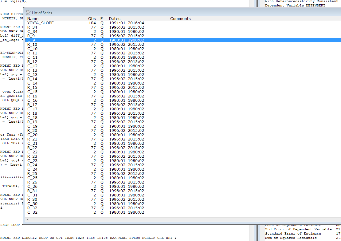

One more question: since these loop was after many other loops in the code, the error terms and coefficients are not marked from 1 - 22. Do you know what causes it? Can we somehow to force it run from 1 - N of linear regressions.
Re: How to save coefficients and residuals in the loop?
Did you write %s("R_"+%l(i)) (as I wrote) or %s("R_"+i)? The former uses the labels, the latter just uses the sequence number.

Oops. My faults. Exactly, I used %("R_" +%(i)). Thank you very much.
