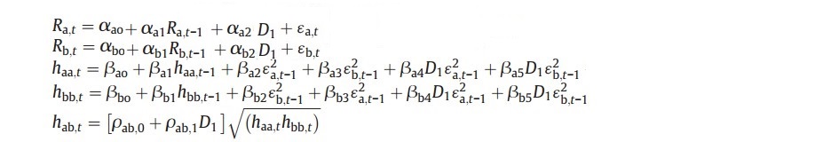

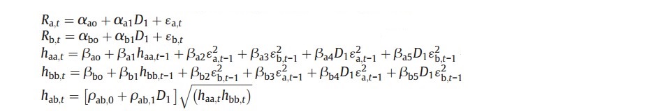

I wish to run a bivariate Garch model similar to the one in section 5.3.1 Sun et. al. 2009 (Sun, Q., Tong, W. H., & Yan, Y. (2009). Market liberalization within a country. Journal of Empirical Finance, 16(1), 18-41.). The model I intend to run is in the attached pic. Ra and Rb are stock returns in two markets and D1 is a dummy variable indicating a time period. I wonder how can I run this model in RATS?
Thanks a lot!
Jason

Re: Bivariate Garch Model with dummy and interactions
That's an extension of a "spillover" CC model. The attached program applies that to a pair of series from one of our stock data sets.

I know it is a lot to ask, I wonder if can I put the one lagged return in each mean equation? What adjustments shall I do to the codes you wrote before?
Thank you so much!
Jason
Thank you so much!
Jason
Sure. Just change the mean equations:
equation eqn(1) xfra
# constant dummy
equation eqn(2) xsui
# constant dummy
to add the lagged dependent variable to each (xfra{1} in the first equation, xsui{1} in the second).
