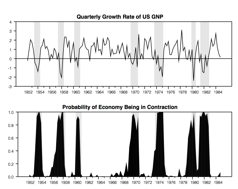

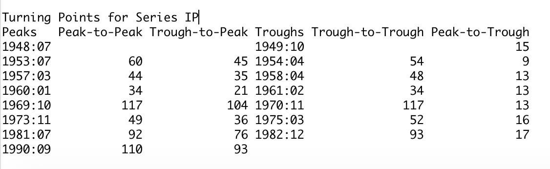

Is there any possibility to:
1- get the outputs for the BB algorithm in graph as well ? we only get numbers .
2- get Hamilton's MS-AR graph in color rather than in Back and white only?
Please have a look on images attached
Best regards
D
Best regards
D
- Hmilton's results - Any colored Graph version
- Screen Shot 2017-04-10 at 11.50.00.png (111.53 KiB) Viewed 25603 times
- BB Results - Any colored Graph version ?
- Screen Shot 2017-04-10 at 11.46.54.png (61.89 KiB) Viewed 25603 times

You can use the PEAK and TROUGH options to get dummy variables with the turning points. I'm not sure there's any obvious "graph" directly out of the procedure, but you can use those dummies in other graphs.danon wrote:Dear Tom,

Color what? You can change the color on the data by overriding the default style number (1 = black).danon wrote: 2- get Hamilton's MS-AR graph in color rather than in Back and white only?
