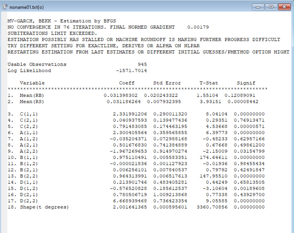

I am sorry but this is the output I am getting. I did multiply returns with 100. It says no convergence. Any suggestions? please
