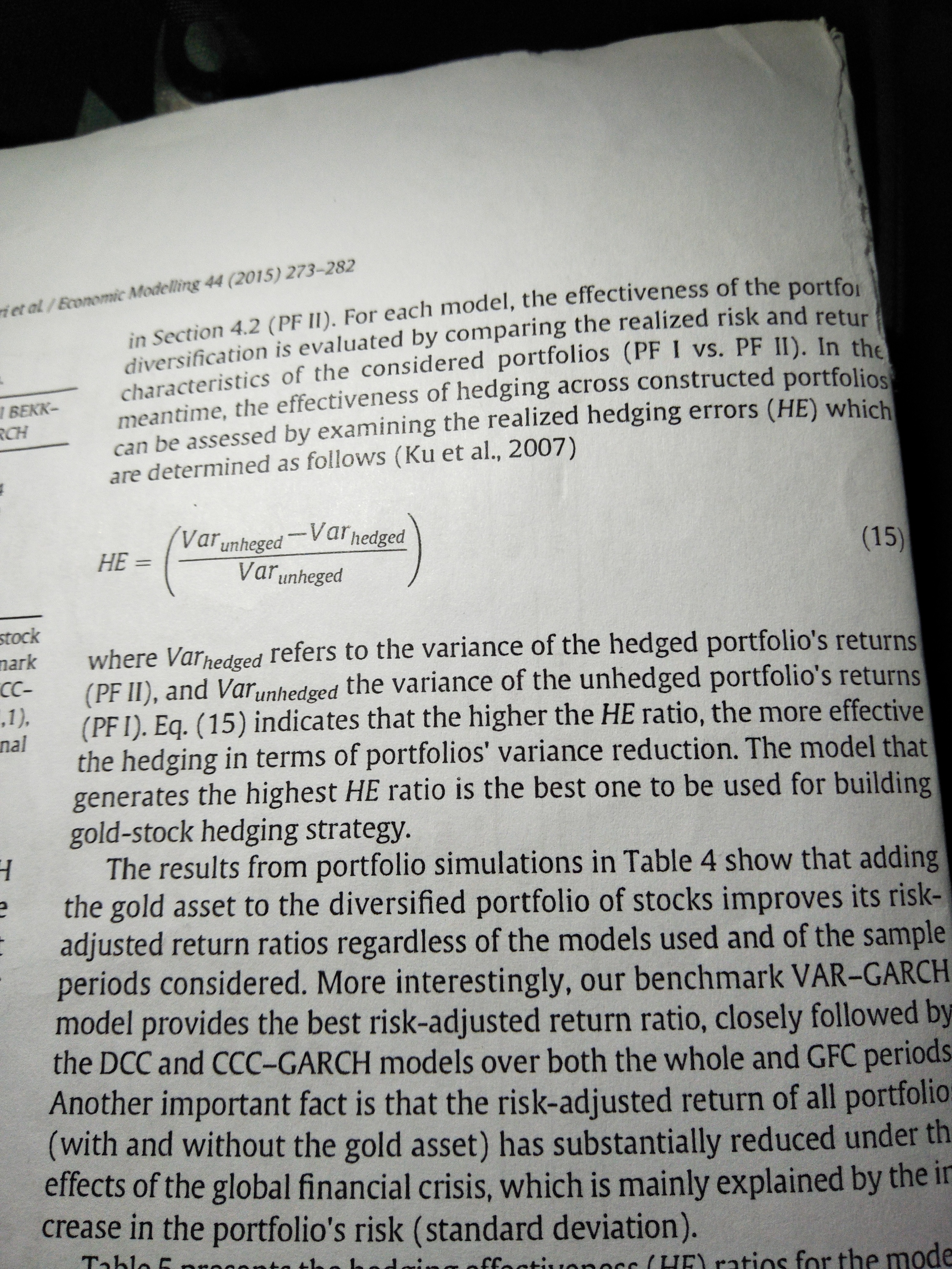

There is a attached documents having hedging effectiveness formula.
Now, kindly guide me, how can i calculate hedging effectiveness.
Posts: 7825
Re: VAR AGARCH model (optimal weight, hedge ratio and Hedgi
That's the general formula for any type of hedging strategy with any type of portfolio. In this case (two assets, shorting one to hedge the other), I believe it's the squared correlation.

Kindly tell me, how can i calculate variance hedged and variance unhedged in RATS? What can be the code?
Posts: 7825
Have you read Kroner Ng(1998), section 5, which describes the type of strategy being used? (The paper you cited is relying entirely on that).
