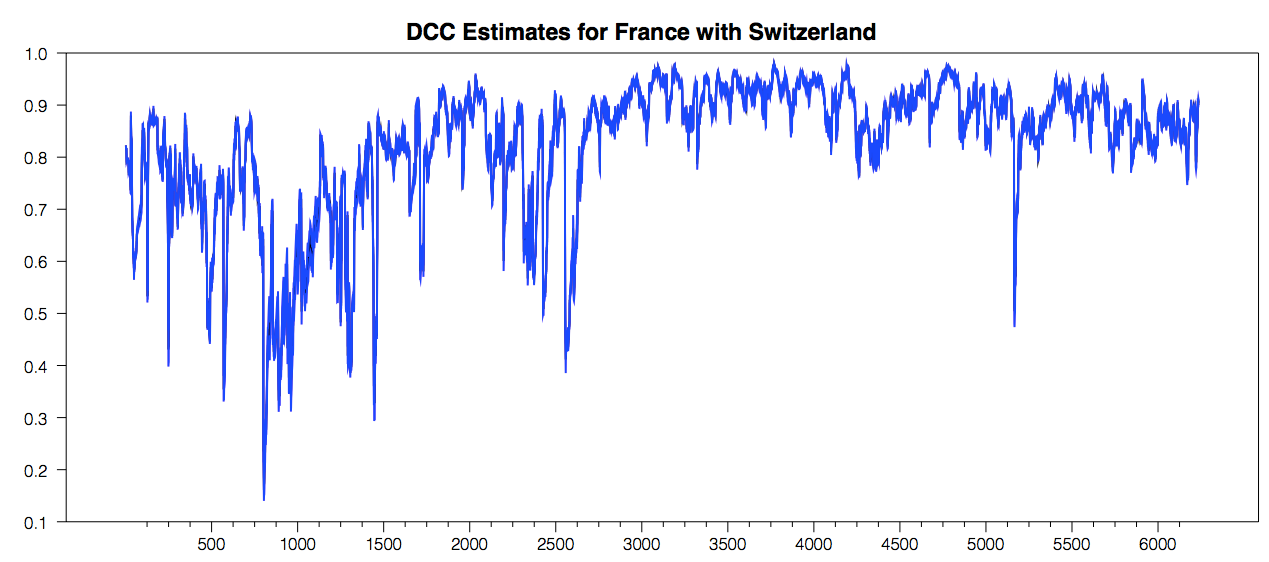

Hello,
I run the graph, but unfortunately, I cannot see any confidence bands in the graph.Thank you for the help.
- graph.png (145.23 KiB) Viewed 11728 times
Re: DCC GARCH Model with Metropolis-Hastings
From the comments:
* Generate the median and 90% confidence band for the DCC correlations.
* For this data set, the period to period movement is large enough
* relative to the spread that the three lines basically end up on top of
* each other. If you graph over a shorter period, you can see at least
* some spread between the upper and lower bounds.
