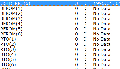

Many thanks for your reply. Actually, I want to calculate (say X1, X2, and X3) the portion of X1 can be explained by X2 and X3 at the Structural decomposition at step K (from others), and the portion that X1 contributes to X2 and X3 at the decomposition of step K (to others). Then, similar to Diebold and Yilmaz (2011), the net influence may be gauged as the difference of "to others" and "from others".
To further check this from time-varying perspective, I want to adapt the RATS replication codes and calculate the above "from others", ''to others" with a fixed rolling window (span=200). Meanwhile, I want to restrain the estimated A-matrix unchangeable, while only updating the VAR coefficients and %sigma. In my opinion, though I may need to rethink the "spillover" explanation, the calculation process resemble that of Diebold and Yilmaz (2009,2011). The only difference is that I use the structural decomposition, instead of generalized (or Cholesky).
I revise the loop codes as follows, without re-estimate the A-matrix using CVMODEL. Though it not reports any error, all the calculated series are empty with no observations. Could you tell me why?

I told you why---you have the compute RSTART and REND in the wrong place. You didn't get rid of the incorrect one that's the first line in the code snip that you posted.
But the point remains that in a structural model, the shocks aren't "X1", "X2" and "X3" so the "from others" and "to others" labels don't make sense.
