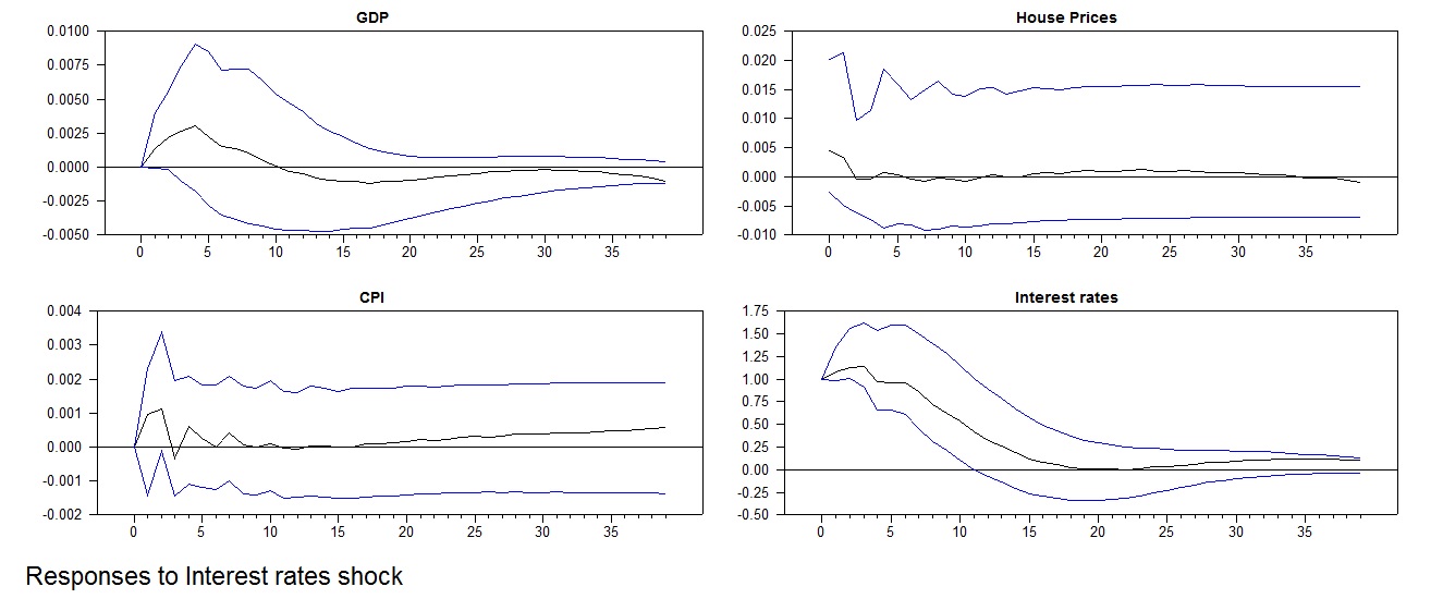

Thanks! I fixed it and accumulated only differenciated variables. I altered the code a bit and got more reasonable results. Still I'm bit worried about my IRF's after Monte Carlo integration. For the United States the results for real house prices and GDP to interest rate shocks seem to be quite different from the Bjornland (2010) mentioned above or Bjornland (2008) "the role of house prices in the monetary policy transmission mechanism in the u.s", in these papers there is statistically significant decline of both gdp and real house prices in response to int. rate rise. I tried to replicate Norway from Bjornland (2010) and got similar (insignificant) results. So my question is:
Can you see any other mistakes in code that would influence my IRF's? Thanks. Sorry for being this vague.

Re: need small troubleshooting about VAR.
I assume that the published work was subject to the same error described in another thread beginning at:
https://estima.com/forum/viewtopic.php?p=7974#p7974
