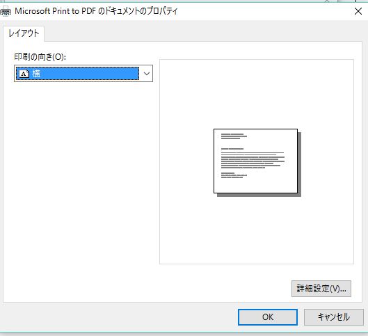

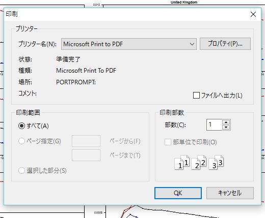

Re: plotting IRFs - line pattern
How did you produce graph01.pdf?
cczzwhy
- Posts: 48
- Joined: Tue Jun 16, 2015 3:47 am
I used the print window as in the graphs I attached( i am sorry that I am using the Japanese version right now,so i will try to make it clealy).
Step1,I clicked the print button to produce a print window.
in step2 i checked the button which means[ export to file] in the print window.
In step3 i changed the layout to landscape form ,then it can be exported as a graph pdf to file folds .
These are the steps i got the as showed in graph01.pdf .I am not sure if I told it clearly...
