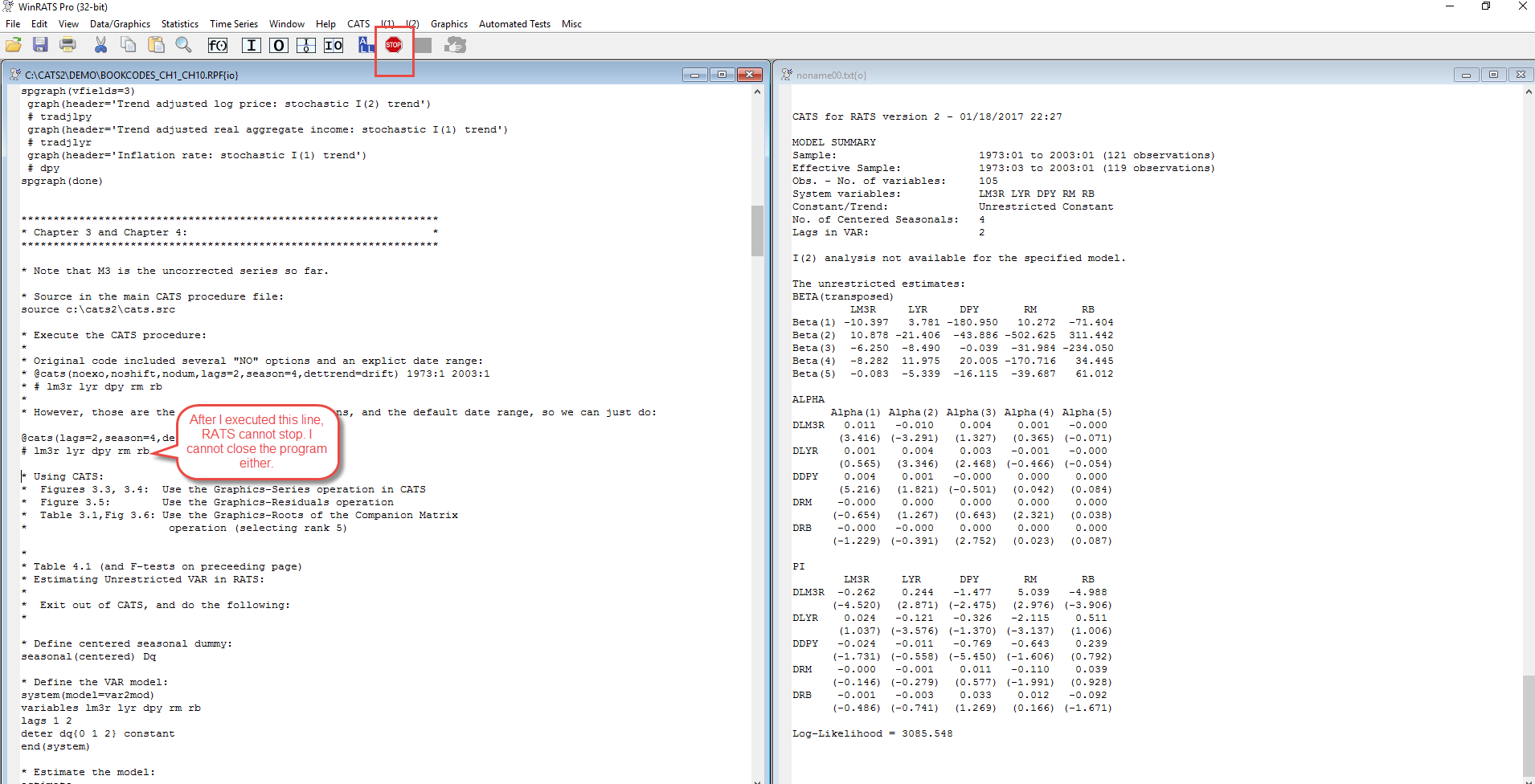

I have RATS 9.1 and just installed CATS2.0. I was running the demo, but after processing code
@cats(lags=2,season=4,dettrend=drift)
# lm3r lyr dpy rm rb
I can obtain the value for beta, alpha, pi. However, the program kept running and cannot stop. I cannot close the software without using the Task management to force ending the task.
Later, I tried to apply cats on a simple dataset, and I still met the same problem.

TomDoan wrote:What happened when you used the CATS menu?
Thank you, Tom. The problem is solved. I did not realize that in order to use CATs menu, I should keep that "Stop" sign on. Thank you so much!
