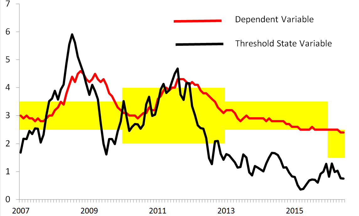

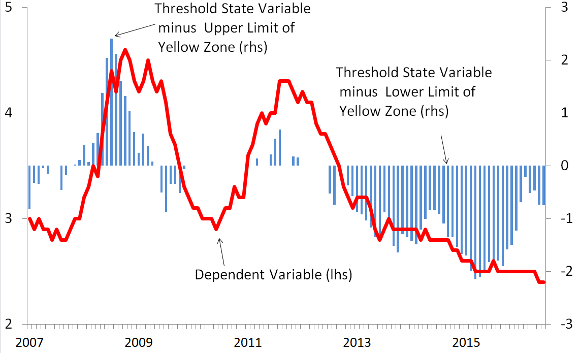

I am working on ‘TVAR model with 3 regimes with 1 threshold state variable’ through modifying TVAR_IRF.rpf (Balke(2000)). First of all, please see my 2 pictures. Let’s suppose that ‘yellow zone (YZ)’ is the optimal band of foreign reserve (exogenous and not fixed for test horizon), ‘threshold state variable (black line)’ is actual foreign reserve, and dependent variable (red line) is exchange rate. Of course, these are all virtual data.
Question 1.
As you can see, because threshold values (upper limit and lower limit of yellow zone) are changing, RATS coding is not easy. So I converted from the first graph into the second graph in order to fix only one threshold value as zero. The second graph composed of 3 regimes - (1) Threshold State Variable > Upper Limit of YZ, (2) TSV in YZ, (3) TSV < Lower Limit of YZ. In this case I think that structural threshold VAR model could be as follow (modification of the first equation of Balke(2000)), Do you think that this is right?
Yt = A_1*Yt + B_1(L)*Yt-1 +
+ [ A_2*Yt + B_2(L)*Yt-1 ] * I_u [ TSV – upper limit of YZ > 0 ]
+ [ A_3*Yt + B_3(L)*Yt-1 ] * I_d [ TSV – lower limit of YZ < 0 ]
+ et
I_u : indicator function, if ‘TSV – upper limit of YZ’ > 0, then I_u = 1, otherwise I_u = 0
I_d : indicator function, if ‘TSV – upper limit of YZ’ > 0, then I_d = 1, otherwise I_d = 0

I want to code 3 variable (dependent variable(red), threshold state variable, another variable) TVAR with 3 regimes by 1 threshold state variable. Although I am trying to do this, this is never easy job – frankly speaking, I am not familiar with bootstrapping codes. Mr Doan, don’t you have already the code of 3 variable TVAR with 3 regimes by 1 threshold state variable? If you don’t, please give me some useful advices in coding this model as specific as possible. I already know that you referred to this a little when you uploaded TVAR_IRF.rpf on Jan. 14, 2014 in the RATS forum – you said that we don’t need to modify line 112~205 and line 212~315 of TVAR_IRF.rpf. However, this is TVAR model with 2 regimes by 1 threshold state variable. Therefore, I cannot apply it to my test without modifying much, perhaps, of the code. Related to this work, I also know that Darth Nisis, one of RATS users, uploaded 3 variable TVAR with 3 regimes on Oct. 19, 2015 in the RATS forum. I attached it for your convenience. But I am not sure whether this is the right code or not.
Question 1.
+ et
Question 2.

1. The conditions governing the ‘high’ and ‘low’ branches in my TVAR are just like policy makers’ targets as I referred on Jan. 20. Policy makers set the target zone after considering lots of factors which affect foreign reserve in my virtual example. I record again my example which I wrote on Jan. 20.
(repeated part begins)
As you can see, because threshold values (upper limit and lower limit of yellow zone) are changing, RATS coding is not easy. So I converted from the first graph into the second graph in order to fix only one threshold value as zero. The second graph composed of 3 regimes - (1) Threshold State Variable > Upper Limit of YZ, (2) TSV within YZ, (3) TSV < Lower Limit of YZ. In this case I think that
(I have modified the below equation reflecting your advice of Jan. 23)
Yt =[ A_1*Yt + B_1(L)*Yt-1 ] * I_w [ lower limit of YZ < TSV < upper limit of YZ’ ]
+ et
I_u : indicator function, if ‘lower limit of YZ < TSV < upper limit of YZ’ > 0,
I_d : indicator function, if ‘TSV – upper limit of YZ’ < 0, then I_d = 1, otherwise I_d = 0
(repeated part ends)

Assuming TSV as the threshold variable, yzupper as the upper bound for the yellow zone and yzlower as the lower bound, the following would estimate the VAR in each of the three regimes:
estimate(smpl=tsv>yzupper)
estimate(smpl=tsv<yzlower)
estimate(smpl=tsv>=yzlower.and.tsv<=yzupper)
