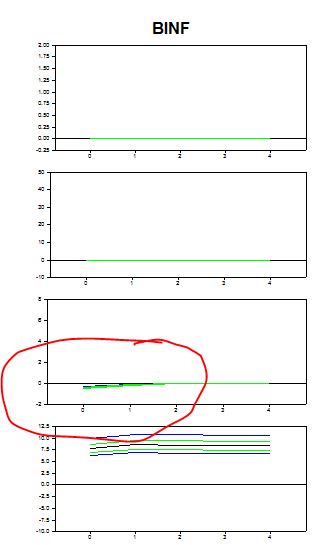

thats the thing, they are not accumulated in my Excel output even though I asked it too, see file attached for output example of a supply shock to bwdi. Clearly not accumulated.Why would you accumulate them in Excel? They're already accumulated before being exported.
I then get following error message:{
if factor(3,4)<0.0
compute factor=factor*%diag(||1.0,1.0,1.0,-1.0||)
## SX11. Identifier FACTOR is Not Recognizable. Incorrect Option Field or Parameter Order?
>>>>if factor(<<<<
Do you know why?

- 3,3.JPG (22.08 KiB) Viewed 19286 times
- Posts: 7825
Re: Near VAR with Long Run restriction
You're using B where the other program used FACTOR.pfb382 wrote:thats the thing, they are not accumulated in my Excel output even though I asked it too, see file attached for output example of a supply shock to bwdi. Clearly not accumulated.Why would you accumulate them in Excel? They're already accumulated before being exported.

The excel output is correct now. With "b" the code also runs through, BUT it does not change the IRF of a demand shock on output as wanted to make the effect positive. Could you help me out there again. Then I will be satisfied. Thanks a lot for all your help!You're using B where the other program used FACTOR.
Regarding the other problem, update your procedures to get a newer @MCPROCESSIRF. (Help--Update Procedures operation).

- IRF 3,4.JPG (28.2 KiB) Viewed 19279 times
- Posts: 7825
You have to do the sign flip inside the loop as well.
