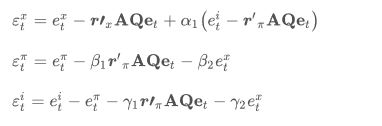

Could you give me a hint for coding up the SVAR model (in the paper A New Keynesian SVAR model of the Australian economy, Shawn Chen-Yu Leu 2011) like
u_x(t) = e_x(t) - r_x'*A*Q*e(t) + a1*(e_i(t) - r_pi'*A*Q*e(t)
...equation (17,18,19) (picture attached).
where u_x(t) is epsilon_x(t) in the paper.
I understand that r_x'*A*Q*e(t) is just forecasted errors of the respective variable but do not know how to write frml to put cvmodel solving structural params.
Many thanks.
Many thanks.
- equation.JPG (13.48 KiB) Viewed 9750 times
