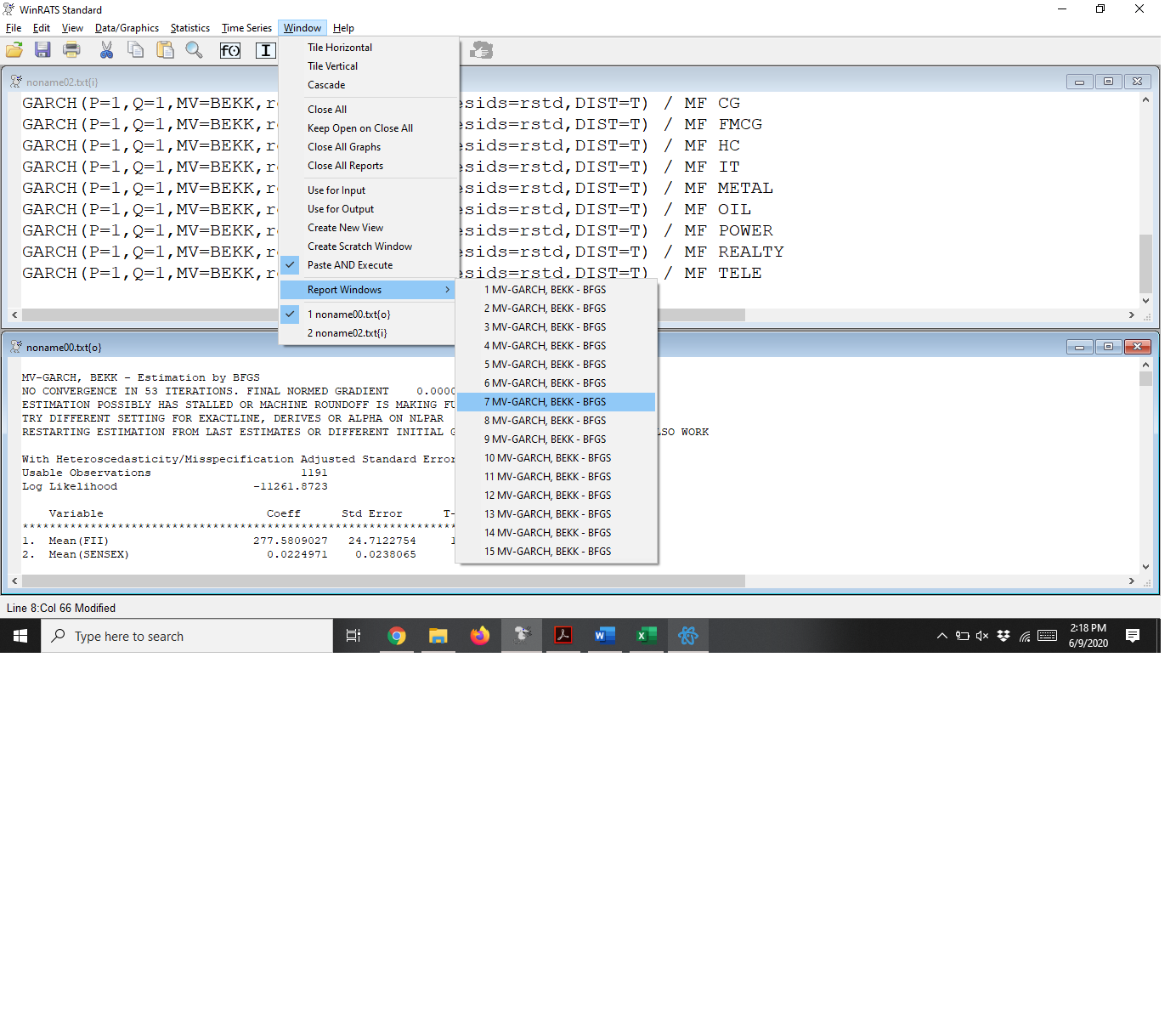

I generally copy paste BEKK results from software in MS excel, but then a lot of time gets wasted in delimit data used text to column. For example i am trying to study volatility spillover among 21 countries stocks markets and there are 210 combinations which i now need to delimit manually.
The software is amazin where we can run codes together and generate output fast for many variables. But the final output somehow doesnt get generated as well
This can be improved

I used the report function and it does allow me to reduce decimals and then save the output by going to export function and saving as comma seperated file. The output is perfect as i want.
But i am only able to do this for 1 bekk garch command at a time. So if there are 15 different combinations, then i have to save 15 times different comma seperated files. Cant i save all the results in a comma seperated files?
This will be real life saver for me and other users like me.
