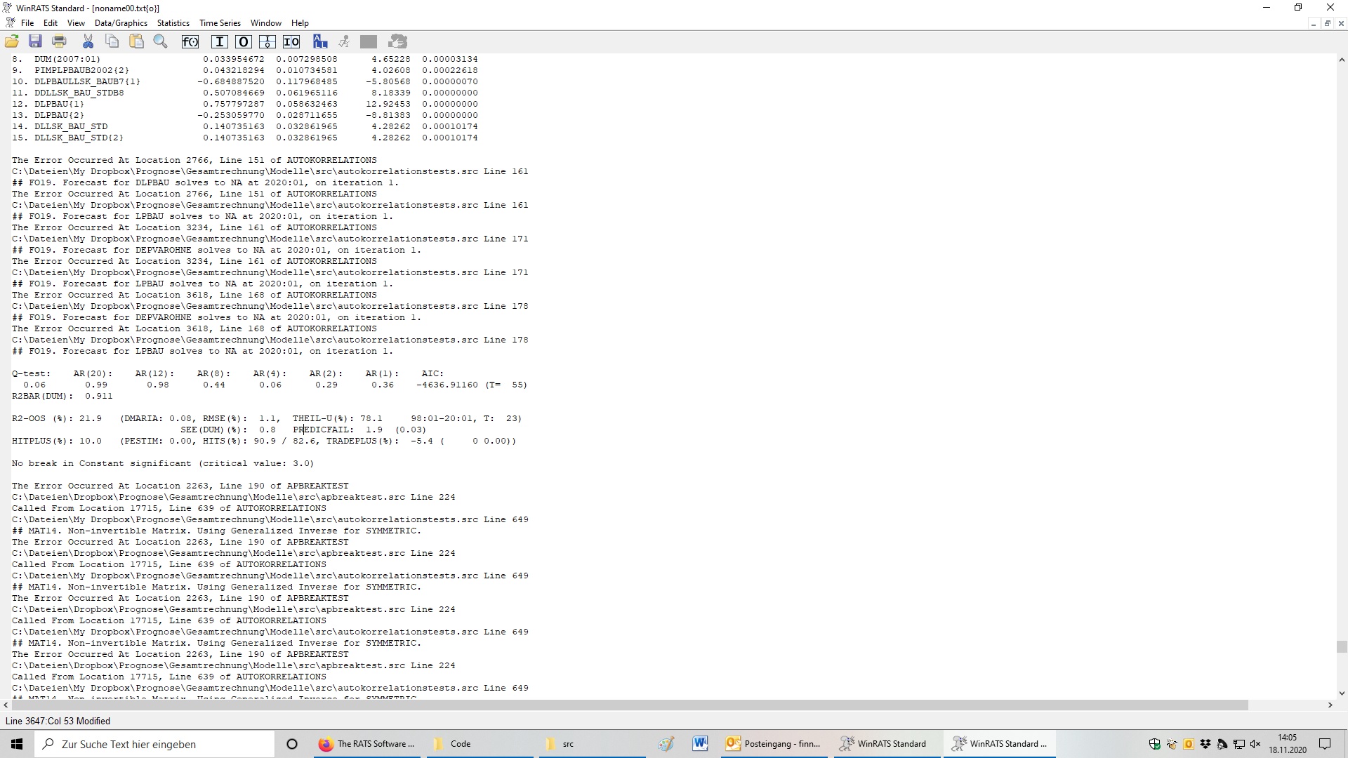

Dear Community,
i want to use the comand "enviroment TRAPERRORS" to suppres errorwarnings like the one that can be seen on the screenshot. When i use the comand "enviroment TRAPERRORS" the error massages are suppresed, but i do not know how to get the errorinfos from the variable %errcode, which regarding the help, should save the errorcode. I tried to display it, with disp %errcode. Have any of u an idea, how i can extract the information from %errcode?
