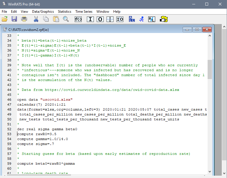

This is a preliminary example of syntax highlighting. (The comments are in green, quoted strings in red; an unclosed quoted string will be red underline). This also shows what this looks like with line numbers.
One minor issue is with the fact that RATS has both input and output windows (and sometimes single windows have both). I'll try to look into how easy it would be to style output differently from program statements.
These would all be set up to be optional with colors that can be selected by the user. Suggestions are welcome.

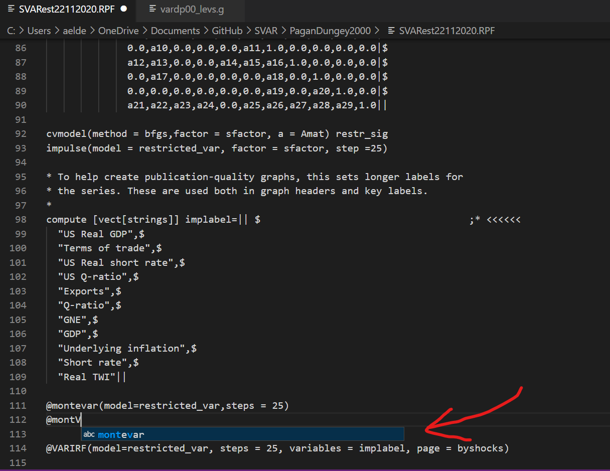

This looks really good! I think there are some really great examples that could be used for inspiration for future development. For example, copying and pasting RATS code into notepad++ or VScode gives user the ability to "tab complete" their coding, by this I mean users can start typing a variable name and all the options of names like it come up (see screenshot for example)
This would make coding in RATS much easier!
