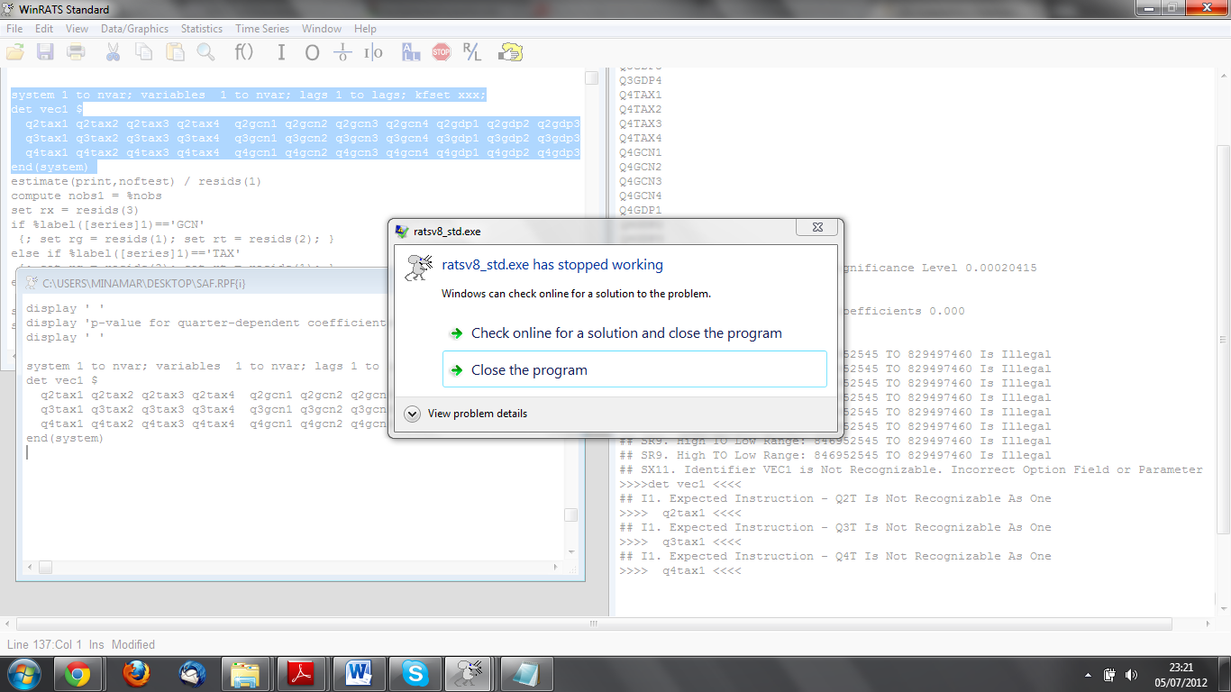

I am attaching again the file of the program i am using, plus a screen shot of what occurs when i am trying to execute the following part from the program named SSA1.PRG
system 1 to nvar; variables 1 to nvar; lags 1 to lags; kfset xxx;
det vec1 $
q2tax1 q2tax2 q2tax3 q2tax4 q2gcn1 q2gcn2 q2gcn3 q2gcn4 q2gdp1 q2gdp2 q2gdp3 q2gdp4 $
q3tax1 q3tax2 q3tax3 q3tax4 q3gcn1 q3gcn2 q3gcn3 q3gcn4 q3gdp1 q3gdp2 q3gdp3 q3gdp4 $
q4tax1 q4tax2 q4tax3 q4tax4 q4gcn1 q4gcn2 q4gcn3 q4gcn4 q4gdp1 q4gdp2 q4gdp3 q4gdp4
Please let me know the outcome.

I haven't been able to reproduce any sort of crash behavior. You may want to double-check that you are in fact using version 8.1. You can do that by starting RATS and doing Help-About RATS to check the version number.
Aside from the "open output" issues addressed in the other thread, there are a couple of issues with this code.
1) It sources in a separate file of commands to do some covariance matrix processing. That's done by this line (which contains both a COMPUTE and a SOURCE command):
compute [label] covmatrix= 'v'+%label([series]1)+'.src'; source &covmatrix
The constructed filename does not match the actual name of the supplied procedure file, so RATS will prompt you to select a file when it tries to execute the SOURCE command. As long as you select what I assume is the correct file (VGCNNP.SRC), execution should proceed normally. To avoid this issue entirely, change the COMPUTE command to this, which includes the "NP" at the end of the filename:
compute [label] covmatrix= 'v'+%label([series]1)+'np.src'; source &covmatrix
Note that this command actually appears twice in the program, so the fix needs to be made in both places.
2) This file actually contains what are essentially two separate programs. As written, it uses this command
end 1
as a way of clearing the memory between the two "programs". That old syntax is no longer supported. Instead, do
end(reset)
to clear the memory before continuing with the next section.
With those changes, the program should run properly to completion.
