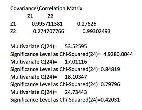

I´m just quickly returning on my previous subject on multivariate Q-test.
I got now following result:
Multivariate Q(24)= 367.13853
Significance Level as Chi-Squared(96)= 2.45577e-033
Seems that the results are extremely high (Q24) and low (chi). Correct me, if I´m wrong: the model used helps to remove large part of autocorrelation? But I´m still quite insecure about the unusually high results.
In the picture I previously sent (and now again). The first and third (Q24) row show the residuals of series, second and fourth row show the squared residuals of each series. So if I´m using both CCC- and DCC-GARCH -models, I have to calculate Q-stat for both of them (like done in example pic, I suppose) ? How I can calculate squared residuals ?
And again, thanks for your patience dear Tom!

Re: Beginner problems in DCC-GARCH
juustone wrote:I´m just quickly returning on my previous subject on multivariate Q-test.
You would have to post your program and data set---I'm not sure why you are showing four different MV Q statistics. That result doesn't look promising, though that's a LOT of lags for a test in a GARCH model.
@MVARCHTEST is used to test for residual ARCH in a multivariate setting---tests on autocorrelation of squares is for univariate models.
Those are the residuals from the OLS VAR. The asymptotics for the MV-Q statistic assume homoscedastic residuals. Since you have strongly GARCHed data, that assumption fails and fails badly. If you get results like that from the diagnostic multivariate test, you should be concerned, but not from the residuals before you take into account the GARCH process.
juustone

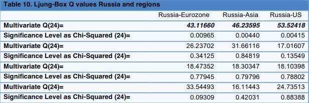

The GARCHMV.RPF program shows standard diagnostics and the GARCH e-course has many examples with interpretation of the results.
I don't know what those other MV Q tests were that you posted earlier, but those looked OK if they were the diagnostics on the jointly standardized residuals.

How does it look like? Any technical interpretation, does it fit well. I am depending much on the RATs Handbook for ARCH/GARCH I got yesterday. Thank you for your help.
Not surprisingly, it doesn't look very good as a GARCH model. Have you done the first step of trying to analyze these using univariate GARCH models? Your results are showing all the signs of data that are dominated more by structural breaks than by a GARCH process.

According to results, used model do not remove the series autocorrelations quite well? Is it same as you got ? And how many lags should be used ?
Thanks again! You have helped me a lot!
I'm really confused about what you're posting. What is Table 10? Your program is for Russia and Georgia, so why are you posting the results for Russia vs large aggregates of other nations?
Your data for Russia and Georgia show almost no relationship between the two---the periods of high volatility are basically disjoint.
