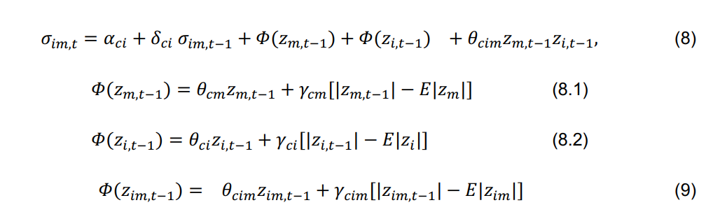

Hello TomDoan,TomDoan wrote:The following estimates a multivariate E-GARCH model with a VAR(1) mean model and spillovers in the GARCH specification. This is from G. Koutmos(1996) "Modeling the Dynamic Interdependence of Major European Stock Markets", Journal of Business Finance and Accounting, Vol. 23, pp. 975-988. The program should require relatively little change to be adapted to other data.
This program is covered in considerable detail as part of the ARCH, GARCH and Volatility e-course.
Version 9 of RATS adds the option VARIANCES=KOUTMOS to allow direct estimation using the GARCH instruction.
I have gone through Koutmos 1996 paper and run your RATs program file, but i have a specific question regarding mEGARCH. I have looked at the mEGARCH specification in Koutmos paper (1996), which he extented from Nelson's paper (1991). Furthermore, another author named Dean and Faff (2004) extented Nelson's uEGARCH to a multivariate case, however, their specification is different from Koutmos. For clarification, I attach the screenshot of the Dean's mEGARCH specification. please have a look. For me, both are different. Isn't it? Unfortunately I am attempting to estimate this attached mEGARCH process, but unsure whether this can be done with RATS functions or need to make new process. Have your comments! thanks.
- cov.png (54.22 KiB) Viewed 18393 times
Re: Koutmos JBFA 1996 Multivariate EGARCH
That's not really enough information to tell for certain (there's no definition of the z's, but I assume they're the standardized residuals). Assuming that's actually an EGARCH (i.e. the variance is the exp of sigma), it adds that final interaction term in the first line (the z x z term) to the Koutmos model. Another possible (likely?) difference is that Koutmos uses a single asymmetry term for each variable across all equations (note that common d(j) in the Koutmos formula), which it looks like this model allows for freely estimated coefficients (the coefficients are double subscripted which would seem to indicate that each is different for each equation).
If you want to do that, you'll have to base it off the pre-version 9 program.

yes, z is standardized innovation. The subscript c in each coefficient indicates that coefficients belong to covariance specification. The subscript m and i refers to market and stocks/portfolios where i=1,2,...n, respectively. The estimation is bivariate, meaning that each time two series (i.e., one stock and the market) enter into the equation and thus, computation. I have some queries to ask for clarification,I don't know whether these are elementary.
Since the equation 8.1 and 8.2 is univariate egarch, both are easy to perform. The question is about interaction term in equation 8 and 9. It seems that z_m and z_i are in the form of multiplication. If I perform multiplication element by element (z_m*z_i), the resulting vector is one column vector in which uEGARCH is possible to perform (I don't know whether this computation is correct and therefore, asking to know?). Altogether, there are three system of equations from which I need to obtain conditional covariance (i.e., the regressand in equation 8 ). The big question is How I can obtain this covariance? Your suggestion can be helpful.
I am sorry to say that I am novice in RATS.Since there are a few softwares where megarch is possible to implement, I had to switch from other used softwares.
N.B. the computation of the interaction term, z_m*z_i might also be done by calculating covariance between z_m and z_i and thus, the same process as mentioned (I am unsure whether it's correct approach).
This is clearly a joint estimation since each variance depends (through the z's) on the lagged variance of the other series. Are they using CC to handle the covariance?
The interaction term isn't a major problem---since each of the z's is scale-free so is their product and both the z's have to be computed to handle the more standard EGARCH terms.

yes, I think that they employ CC. The conditional covariance obtained from equation 8 are then used as conditional price of risk for stocks (that is, the CAPM beta). For details, please have a look at the Empirical Framework of attached file.
Looking forward to your reply.
The description of what they actually did is very vague. It sounds like they first estimated univariate E-GARCH models, used those to generate the z's, then somehow went back and re-estimated the model using that. There is no earthly reason to not do a full ML estimation of that now, and I doubt there was a reason to do that 15 years ago. Koutmos' paper is eight years older and handles a similar model with 4 variables rather than 2 and does ML.

hm. So, you prefer not to go with their egarch specification, do you?. yes, the explanation of covariance specification is vague in that equation terms are not explicitly expressed out. However, at the outset the covariance specification is appealing at me because of joint asymmetry (sign and size terms) in addition to the single asymmetry terms; they all are in a single specification. Besides, I have found this kind of specification in case of multivariate DCC (or ADCC) E-GARCH in R where joint asymmetry appears after each individual asymmetric terms. What do you think about DCC E-GARCH?
Asymmetric terms in Koutmos model are constrained, which is documented in Jane and Ding paper (2009). They show a general extension of Nelson's univariate egarch specification.
