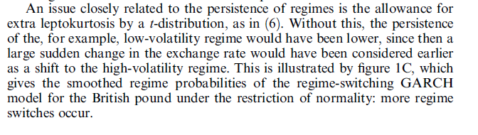

TomDoan wrote: Note, also, that the only thing that takes out of Dueker is the t-distributed errors. Other than that, they're using the Gray filter.
In this article the author says that:
https://link.springer.com/article/10.1007/s001810100100
Re: Gray JFE 1996 Markov Switching GARCH model
I'm not sure I understand your point. Yes, they used a t distribution. And yes, that's the only thing that they took out of Dueker.

Yes, the model has different means in the two regimes.
Again, you're using guess values that may have been appropriate for the interest rates in Gray's paper, but won't be for stock market returns. Also, wasn't their result that the main difference was in the degrees of freedom? Your guesses have the same degrees of freedom and so won't steer the estimates in the desired direction. With everything switching, this almost certainly has multiple modes.
