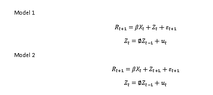

Thank you for the reply. I have a new question now. So far all the examples I read about state-space model are focusing on the contemporaneous relationship between the dependent variables and the unobserved state factors. I would like to know whether it is possible for us to include the lagged state factors in the measurement equation. Is there any existing example I can take a look? Many Thanks!

Hi, TomTomDoan wrote:Didn't you already ask about the Kim and Nelson example with four lags of the cycle on one of the series?
Thanks for the reply. I remember the Stock and Watson's example from the KIM and Nelson's book. I guess I did not make my question clear to you.
For exmaple, I have two very similar models and the only difference is that in model 1, the state variable is lagged ; but the state vairbale is not lagged in my second model. I am wondering how the computer can tell the difference here since the MU, A, C, F,SV,SW are the same for both models.
- mode1.png (2.71 KiB) Viewed 21657 times
Re: Identification issue in State-Space model
If there is no correlation between u and epsilon and there is nothing else in the model, those two representations are effectively identical---you'll get exactly the same log likelihood with the only difference between the entry mapping in the Z process. In order to implement this as model 1 (with Z dated one period before the observable), you would need to augment the state to include a lag, that is, you need the state to read
