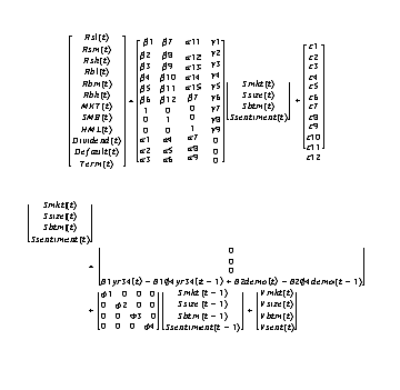

I am trying to replicate and extend their study. In my model, I am trying to identify 4 unobserved factors. The 4 factors are mkt, size , btm and sentiment. My dependent variables are returns on 6 size and BTM sorted portfolios (Rsl, Rsm, Rsh, Rbl, Rbm, Rbh). Following He, Huh and Lee (2010), in order to identify mkt , size and btm, I imposed the same restrictions as they did in the paper. I allowed Mkt to have different effects on the 6 portfolios but, size to have the same effect on portfolios from the same class, big or small class, and btm to have the identical effect on portfolios from the same class, high, medium or low class. In order to identify sentiment factor, I imposed gamma1 to be 1. All the unobserved factors are assumed to follow a AR(1) process and sentiment is affected by dummy variables (yr34 and demo) . However, the estimated results seem to suffer from no convergence issue as the program indicates no convergence in 100 iterations. My understanding is that the no convergence means that either the model specification is problematic or the initial values I assigned are problematic. After many tries, I am not sure what my problem is. My code is attached so you can see what I have done so far. Any suggestion from you are highly appreciated

dlm(presample=ergodic,a=af,c=cf,z=zf,f=f,sv=svf,sw=swf,y=||sl,sm,sh,bl,bm,bh,Mktrf,SMB,HML,dyield,Default,Term||,method=bfgs,type=filter)
- model
- model.png (10.1 KiB) Viewed 23784 times
Re: Dynamic Factors and Asset Pricing (He,Huh, and Lee, 2010
If it's simply not converging in 100 iterations, give it more. That's a fairly large parameter set.

You have an error here:
set bl1 = bl=blm
with an = rather than a - over on the right side.
Have you checked to see if the statistics on the raw data roughly match with theirs?

Thank you for the reply. One of the contributions for the paper is that the authors are able to obtain the ex-ante factors and find that the ex-ante factors are key components in asset pricing and predicting. I understand that DML does not give ex-ante factors, I am wondering what I need to do in order to generate those ex-ante factors as the authors did in the paper. In addition, could you please let me know how I can preform the Fama-MacBeth (1973) two-pass cross sectional regression in Rats? Thank you.TomDoan wrote:If you square a parameter, its sign is arbitrary so don't worry about that.
set bl1 = bl=blm
Next period's predicted states are this period's filtered states premultiplied by A. Since A is a diagonal matrix with constants (free parameters, but constant across time) on the diagonal, the ex-ante factors are (effectively) just last period's filtered factors.
