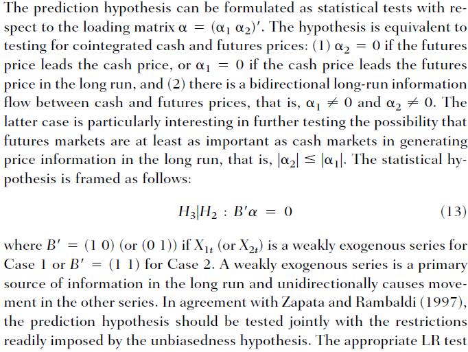

I am grateful for your reply. I would like to know are the short-run non-causality test are different than weak Exogeneity or not. My argument behind doing the test Beta(transpose)alpha = 0 is to test the importance of spot and futures market ( error correction term alphaspot and alphafuture ). According to Yang, Bessler and Letham(2001):
test on alpha.jpg (92.44 KiB) Viewed 12149 times
I have a doubt how to implement the test. Is it same with weak exogeneity test or not?.

The zero restrictions on alpha are exactly the same thing as weak exogeneity (which means, more specifically, weak exogeneity for estimating beta). If the loading on one of the series is zero, then that series is weakly exogenous---it has no direct information on beta as the error correcting adjustment doesn't apply to it, only to the second series.
