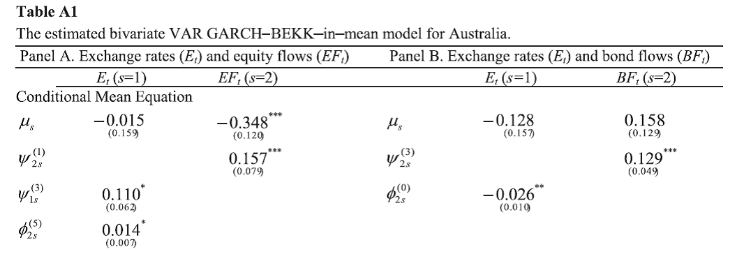

May I ask another question about the results in paper[Exchange rate uncertainty and international portfolio flows_ A multivariate GARCH-in-mean approach(2015)*],the Phi got lags,what should I do to generate it?
- meaneq.png (74.29 KiB) Viewed 17671 times
Re: VAR GARCH-M Model
BEKKHMatrix(1,1) and BEKKMATRIX(2,2) are series, so you can use lag notation {lag} with them. I assume they started with a full VAR with quite a few lags and cut it down to what they're showing. Note that they have different mean equations between the two equations, so that will be more similar to the example in GARCHMV.RPF with separate equations.
