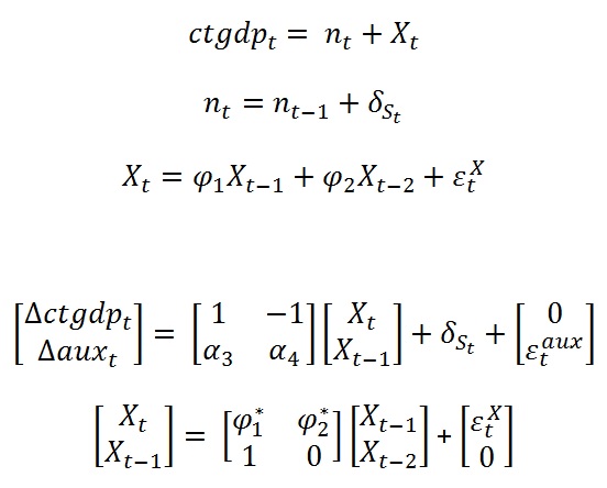

Thanks Tom. When considering the Markov-switching trend I am taking a slightly different approach to the authors in the paper linked in my OP and amending the replication file for Kim's representation of Lam's generalised Hamilton model (kimnp111.rpf). I am continuing to use an auxiliary observable in identifying the cycle. The C matrix that I have specified as a result of having the auxiliary information has a different dimension to that in the Kim and Nelson text and it leads to some difficulty in the Kim filter set up. I have made some amendments in the attached along the lines of what I had thought would be necessary, but no success in estimating thus far. Any suggestions would be appreciated. The specification I am aiming for is attached in the jpg.

You can't use FRML's for the components for doing the Kim filter. Anything that depends upon free parameters (such as your C matrix) needs to be computed as part of the DLMStart function
