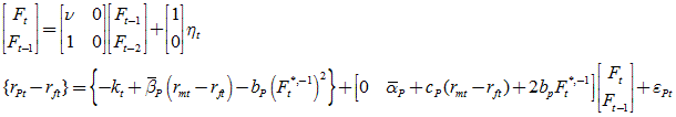

That requires augmenting the state vector with a lag of F since it's F(t-1) that enters into the measurement equation, not F(t). The state and (linearized) measurement equation are:
In the measurement equation, the first term on the right in {...} is the "MU", and the matrix in [...] is the C. Both of those depend upon the expansion point, which I've written as F^{*,-1}_t. The paper says it's doing the expansion around the expectation of F(t-1|info through t-2), but you actually can use the expectation of F(t-1|info through t-1), since this is being evaluated at t, so all information through t-1 is a valid input. (That's why I chose a rather odd notation, to make clear that this is a time t calculation).

This is the TeX code for the description of the model above:
\[\begin{array}{l}
\left[ {\begin{array}{*{20}{c}}
{{F_t}} \\
{{F_{t - 1}}} \\
\end{array}} \right] = \left[ {\begin{array}{*{20}{c}}
\nu & 0 \\
1 & 0 \\
\end{array}} \right]\left[ {\begin{array}{*{20}{c}}
{{F_{t - 1}}} \\
{{F_{t - 2}}} \\
\end{array}} \right] + \left[ {\begin{array}{*{20}{c}}
1 \\
0 \\
\end{array}} \right]{\eta _t} \\
\{ {r_{Pt}} - {r_{ft}}\} = \left\{ { - {k_t} + {{\bar \beta }_P}\left( {{r_{mt}} - {r_{ft}}} \right) - {b_P}{{\left( {F_t^{*, - 1}} \right)}^2}} \right\} + \left[ {\begin{array}{*{20}{c}}
0 & {{{\bar \alpha }_P} + {c_P}({r_{mt}} - {r_{ft}}) + 2{b_p}F_t^{*, - 1}} \\
{{F_t}} \\
{{F_{t - 1}}} \\
\end{array}} \right] + {\varepsilon _{Pt}} \\
\end{array}\]
