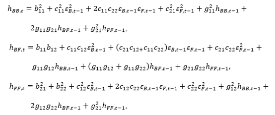

I also want to calculate the the two conditional variance and one conditional covariance equation (I've attached a picture). Is RATS able to do that?
- Var Covar Equations.PNG (31.46 KiB) Viewed 175269 times

That's just what you get when you multiply out the equations for the BEKK GARCH. That's what the GARCH instruction produces as I described earlier.humyra wrote:I also want to calculate the the two conditional variance and one conditional covariance equation (I've attached a picture). Is RATS able to do that?
