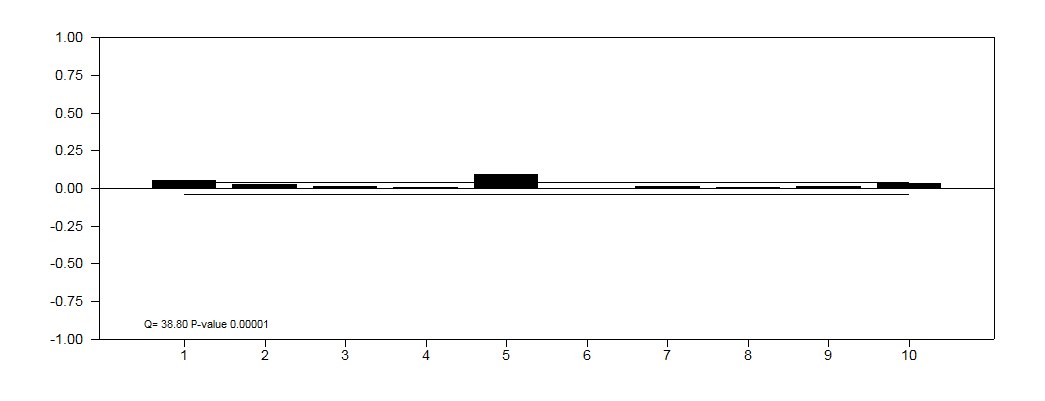

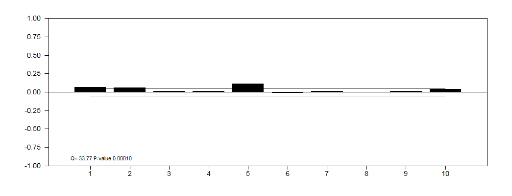

Based on the course, I used two distribution for estimation: normal and t distribution.
But the results are very different about my policy variable "DUM".
When I use normal distribution, policy variable "DUM" is insignificant.
But when I use t distribution, it is significant. And although there is serial correlation between residuals, but there is a huge improvement for log-likelihood from 11807 to 11981.
I do not know which one I should choose because the results will be really different. Here is the results:

I appreciate your help.
The MA{5} in the second half is not significant (its p-value is 0.058). If I delete this term in first half and the whole sample, there will be some correlations between the residuals. If I delete it I do not know how to convince the referee of the paper about the correlations!!!. I certainly use your excellent comments.
Here is Standardized Residuals for total observations:
Here is Standardized Residuals for first half:
first half.png (11.97 KiB) Viewed 27525 times
As I said before, my goal is this: I want to see if the introduction of futures contract have led to higher volatility in spot market. I followed your recommendation to use GARCH-X model. I control it by "DU" variable in GARCH-X model. So, I estimate the model with total observations.
But I also want to see if the introduction of futures contract have increased the pace of new information absorption into spot prices. I examine this by comparing the coefficient "A" of these two regressions: one before introduction and another after introduction of contract.
