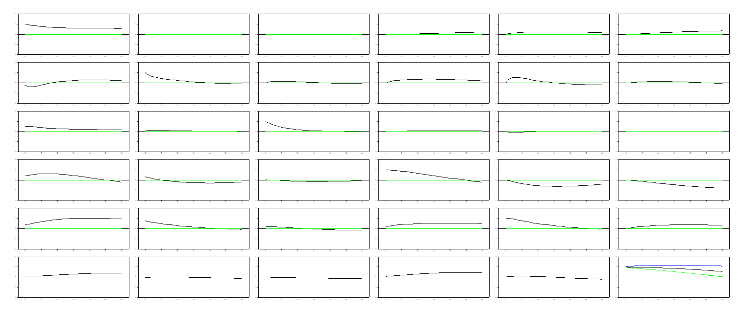

However, everything is fine until I try to replicate the impulse response functions using the command
@dlmirf(a=a,f=sw,steps=30,variables=||"L Response","S Response","C Response","CU Response","FFR Response","INFL Response"||,shocks=||"Shock to L","Shock to S","Shock to C","Shock to CU","Shock to FFR","Shock to INFL"||,results=IRFGRAPH)

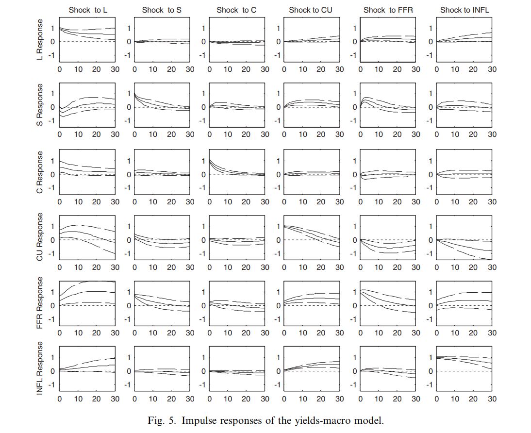

In the attachment there are the estimated IRF and the IRF from the paper.... Why is my result different from that of the paper?

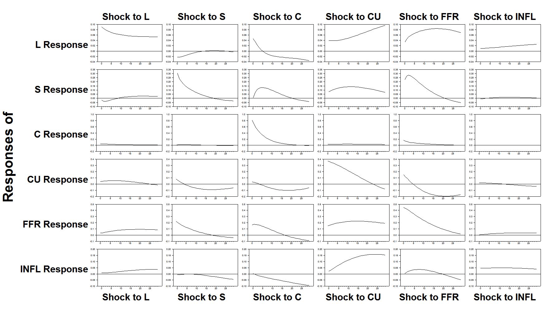

F=SW in the RATS code is definitely not right---SW is the covariance matrix and so has shocks squared (in effect). I'm not 100% sure what their IRF's show. Offhand, it looks like they're doing a Cholesky factor normalized so unit diagonals, though the 5,6 graph doesn't fit that. If that's simply an error, computing
compute fsw=%decomp(sw)
compute fsw=%ddivide(fsw,%diag(fsw))
and then doing the @DLMIRF with F=FSW (and everything else the same) should come pretty close.
It looks like they do "analytical" error bands, which is a very complicated calculation.

Thanks for the reply! Now the impulse responses are in line with these in the reference paper.

That's in a technical appendix of the working paper. Isn't it in the published paper as well?

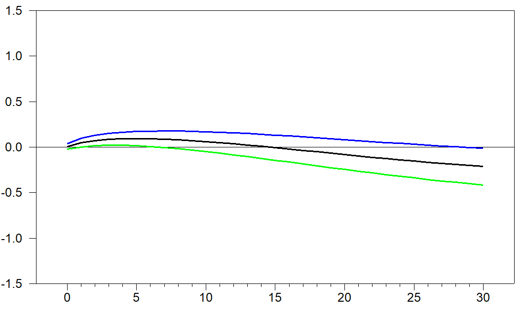

As an example, here is a replication of an IRF of DRA(2006) in Figure 5 (Shock from Federal Funds Rate to Inflation, paper in attachment):
However, my problem is, if I try to plot all the impulse responses + error bands at the same time by using the following loop:

Only the error band of the last response (see the Shock from Inflation to Inflation, the lower right hand corner of the figure from the my second last post) is estimated, and for the rest, yes, no confidence bands.
