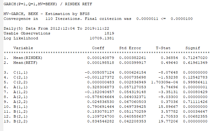

Hello everyone,
I am trying to find volatilty spillovers,so I have two daily return series RINDEX and RETF. I calculated a BEKK GARCH model in WinRats with RINDEX and RETF as the dependent variables. How do I interpret the results? or is the methodology not suitable?
Thank you

See https://estima.com/newslett/Apr2019RATS ... pdf#page=3. Yes, BEKK models are what are usually used for "spillover" tests. As described in that article, the results of those can be somewhat misleading.
